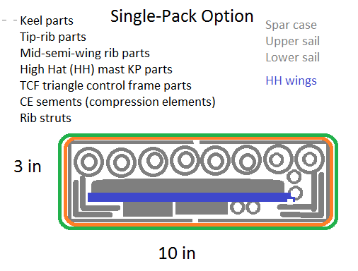

I was awakened by a progress note:
Stick-like items to form inner bundle: (each item: 48 inches or shorter)
:arrow: keel made of 2 parts
:arrow: kingpost made up of 2 parts (aka: HH mast)
:arrow: 2 HH wings (high hat wings are small)
:arrow: 12 or more parts for mid-semi-wing ribs, two parts make each rib
:arrow: 6 or more rib struts (single part per strut) for mid-semi-wing support of ribs (torsion transmitters)
:arrow: 4 parts to make up two tip ribs
:arrow: Several compression elements
:arrow: 2 rig rings (possibly made of parts) {or not such parts}
:arrow: 6 parts for TCF (triangle-control frame), unless 48" side beams suffice, in which case: 3 parts, not 6.
:arrow: Some TE flattish items, perhaps
:arrow: 3-ft-long narrow-profile bags of lines, labeled.
Long wrappable parts:
:arrow: Upper-sail fore strip folded over upper-sail aft strip (tolerate air-flow disturbance of the fold; but perhaps insert between the two strips the lower sail and the spar case in order maybe avoid sharp crease in the upper sail) (embedded rib pockets) {or, if fold crease is not wanted, then go to having two separate strips for upper sail}
:arrow: Lower sail (no folds)
:arrow: Spar case with bladder inside
:arrow: Ground cloth

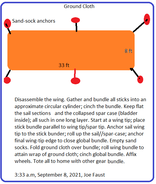

Secondary uses of the ground cloth (low oz/yd2 nylon ripstop)
:arrow: shade cloth. Shade sun, shade wind
:arrow: rest cloth
:arrow: play sail
:arrow: kited play sail
:arrow: privacy blind
:arrow: landing target

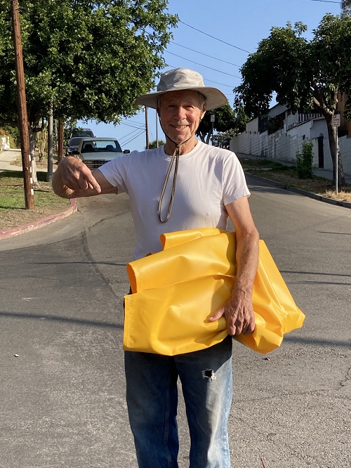

Postby JoeF » Wed Sep 08, 2021 9:25 am
Re: Wing5-M1 or M2

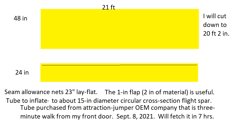

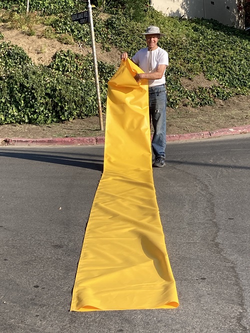

This morning I bought a too-heavy spar case. The 18-oz/yd2 is used in making attraction party jumpers. I have such material, but what I have is dirty. What was just bought was a side-seamed 21-ft tube in yellow. I made the order super simple: 48" wide by 7 yards; sew twice in the 1" seam allowance straight; done. I will pick up the sewn tube between 5:00 p.m and 6:00 p.m.. I will seal the seam; and I will close the ends of the tube. I had the shop sew the one side long seam. I will cut the tube to 20 ft before closing the ends. I will seal the seam with a bead of silicon caulking and/or tape on the inside. The one-inch seam flap may be a foundation for connecting compression members.
I trust that the spar case I bought this morning could be sourced at HERE, but I am not recommending this material for HG spar case; no. Just an experiment. Far too heavy. That online source might later supply other choices; but it looks like they deal in specialty fabrics that are all too heavy for Wing5 iterations. My local shop buys at less, as they buy in bulk.
I will experiment with inflating the tube without a bladder; the material can be made air tight without an interior bladder. I will see how that goes; but I have coming a bladder that could be used to compare experiences. The 10 lb for the spar case is far heavier than I want. The shop has a 10-oz/yd2 in black that would make a 6-lb spar case; that would still be heavier than I want. I do not need the double-side-coated fabric that makes the attraction jumpers, but I want to experience the items for the general project. Black in the sun is not wanted: too hot. So, I might not ever buy their 10 oz/yd2 item.
Secondary uses of the eventual not-flight tubes can be made; exploring those secondary uses will be an adventure in itself. Fold in half, cinch the two ends together, inflate some; have a nice sofa for naps. Etc.
A second spar case of film will be for M1 or M2; a bladder will be used even though the fill could be airtight on its own, but getting the air-tightness might entail too much to do; that will be lighter, but the experience for flight will be different than with the above described 18-oz/yd2 material. I am guessing the film I have may be polycarbonate or polypropylene, not sure; the material was salvaged years ago from the same jumper shop's trash. Hard film; noisy. Not satisfactory, but I want to experience the material for spar making. I will eventually explore spar cases made from different films, fabrics, laminates ....
Eventual spar materials will be light and still resist buckling and torsion while not expanding much during inflation; they will be porous; the bladder will keep the pressurized air. Selection of future M? Wing5s spar case material is not matured. Will be learning much yet about spar case. Laminates might be in the deal. Bias effects? Laminate a net with Dyneema? What design of the net? Many adventures ahead ... I am aiming for 3 lb or less for spar-case. 4 oz/yd2 might satisfy; but that would be the base mark. I'm exploring many materials yet .... One direction: Here. Cuben Fiber, now called Dyneema Composite Fabric

Almost 10 times heavier than target weight:
Postby JoeF » Thu Sep 09, 2021 8:13 am
Wing5-Mx? spar-case inversion and detail work
Work to be done on the yellow too-heavy spar-case in order to explore getting non-bladder airtightness; a bladder may still also be explored for this too-heavy spar care:

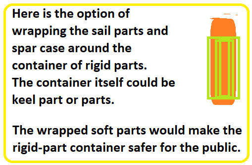

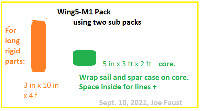

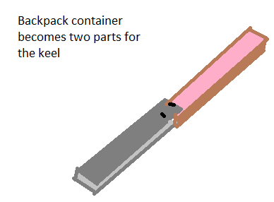

Packing notes for Wing5-M1
Things are coming into focus on toted packs. Have the HG into two distinct sub packs seems to give many plusses.
:arrow: Long sticks: 10"x3"x4 ft ... can neatly backpack with no extending above head; this leaves room for walking without banging bottom of pack.
:arrow: Soft parts: 5"x2'x3' Appears as a piece of normal luggage. The 5" gives wrap radius for sail and spar case with bladder. The interior of the five inches by 24 inches by 36 inches can hold lines and other non-wing items.
:arrow: Bag for free hand holding flight session non-wing items and air pump.
:arrow: Wear harness and helmet. All-in-all the matters seems safe, doable, and with fairly normal appearance.
Option would be to wrap sails and spar case around the 3"x 10" cross-sectioned backpack; lines could also wrap or fit inside with the rigid long parts. Such would leave hands for non-wing items, air pump, food, water. During foot hiking, a small wheel set could be mounted at the bottom of the 4 ft length.
So, both hands will be occupied with reasonable holds.
A narrow backpack of 3" by 10" by 4-ft long will hug body and be hung so that walking heels will not bump into the bottom of the backpack. The 3 inches aft-going thickness will stay in good personal space.
Note: The above would qualify for "4-ft or less" and come within the view of the "5-ft" movement.
Note: Going to 5-ft for the backpack for rigid items remains an option. E.g., if M2 or M3 becomes 25-ft span, and sail part of 5 ft width, then it would be tempting to go to 5-ft for the backpack; in such case it would be tempting to have mid-semi-wing rings be 5 ft in a single piece instead of having two pieces make up those ribs. M1 will explore the 4-ft max-length for any rigid part.
Note: The backpack container could be one of the two parts of the keel; or both parts? Wrapping the spar case and sail around such container could soften the arrangement.
NoteCopyHereRePostedNotes

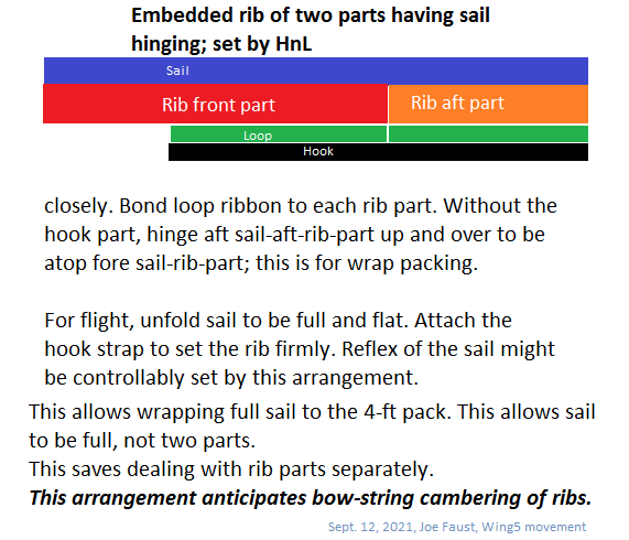

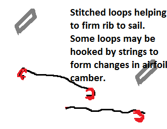

Postby JoeF » Sun Sep 12, 2021 7:00 am

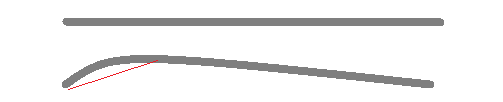

Bow-string cambering embedded hinged ribs

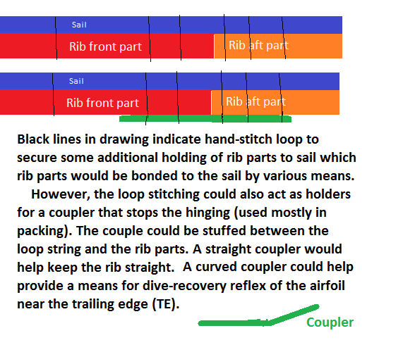

Postby JoeF » Sun Sep 12, 2021 12:11 pm
Option to the above method:
Have various labeled couplers handy to explore reflex at rib stations.
Note: Ribs of two parts: the fore part may be pre-stressed to form camber, but be able in tote wrap to remain flat. The bow-string cambering is an option to use in fore cambering and in reflex shaping.
The hand stitches that help firm the bonded rib part to the sail permanently may be stations for bow strings; the bow strings might have one end or both ends with a small hook for quick hooking. If the bow string is permanently attached to one of the firming stitches, then such could wrap with the sail for tote pack. Or a bow string with a hook on each end could be packed separately and used to form cambers. Various graded double-hooked strings could provide for various cambering to explore various airfoils. Shorter bow string for more cambering in a rib section. Etc.
