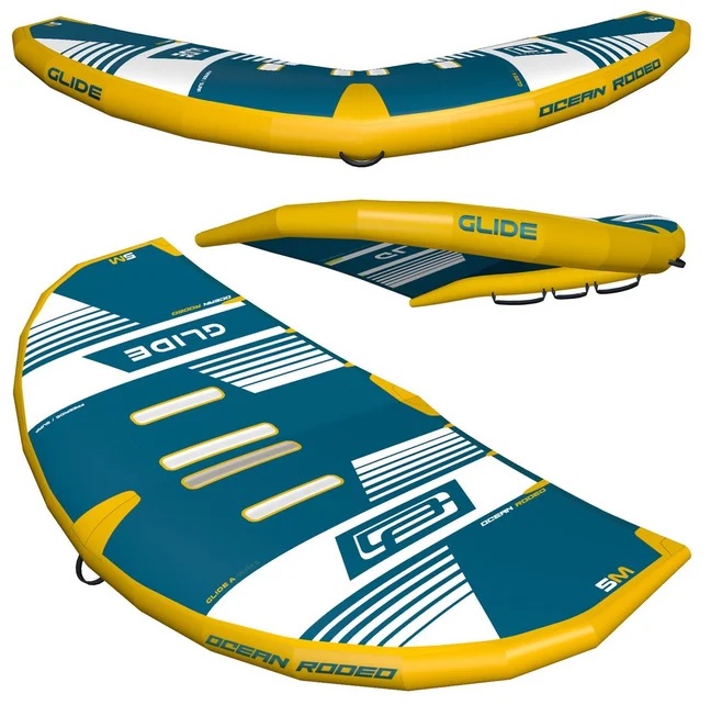

NonSplintHighPSIhandwingOceanRodeo
Ocean Rodeo in glide wing "hand wing" in "A-series", etc .[ not sure of all the trade names yet; check first].. they are exploring composite materials, psi to 12 psi, both in aramid-nylon laminates and also in some black carbon deals, details need closer research; but in summary: they are offering stiffer wings without yet getting into the splinting technology, thus avoiding sticks in airframe, but relying yet on stiffness from advanced materials and high inflation pressures. They are topped out at "7 m" which means 7 square meters; 8 m are hard to find; prices are inching to $3000 for "wing". Pack and tote are within the present project of this discussion thread; and in sufficient wind, a 7 m would glide, but the arrangements are without the yaw control wanted. The low area of 75 sq ft in the "7 m" wing makes for a fast wing; and aspect ratio is low. A mod of such a wing to get yaw control seems doable. DIY to match their finished product is not inviting. So, I am staying toward splinting technology and lower psi in such; and going for more area and higher aspect ratio afforded by going to splinting on the spar; 140 sq. ft looks better to me for use in lower winds and most probable winds at Dockweiler. Ocean Rodeo is playing with Aluula composite and also "Black" material for advanced wings. I am pressing on for DIY lower-cost materials allowable in splinting tech for the inflated spar. When design is firmed and tested well, then splinting with carbon fiber, Dyneema composite sail, may be afforded, but price may discourage. Ocean Rodeo uses word "Glide" their promotions; they are inching close to framed hang gliders for foot-launch in low winds, but are not there yet; their water market is huge $ compared to the tiny or null market of foot-launch hang gliders; liability is less for water works. And if they do get into large "h.and wing" with yaw control and better aspect ratio for framed hang gliders, then my guess at their pricing trend, a price tag would come close to $7,000 or more, my guestimate at this time.
During glide with a "hand wing" the system is a gliding kite system; the system's tether set are the ligaments in the pilot's arms; the anchor system is the mass of the pilot's body; the system's wing flies towed above using the kiting principles.
Video on Aluula Project: https://vimeo.com/352612795
And page https://oceanrodeo.com/blogs/news/aluula-vs-dacron
Not confirmed, but my guess is Kevlar in Mylar laminate; or a weave of Kevlar and nylon in Mylar laminate, not sure; verify, if one needs.....
Their 14.5 meter (about 156 sq. ft) wing carries the area matter, but is formatted for long-line bridling to get form which does not fit the rules for Dockweiler, as such would be considered a paraglider. The kitesurfing kite is used for jumps and glides, but such does not meet Dockweiler "hang glider" rules; paragliders are not allowed to be flown at the Dockweiler slope.
