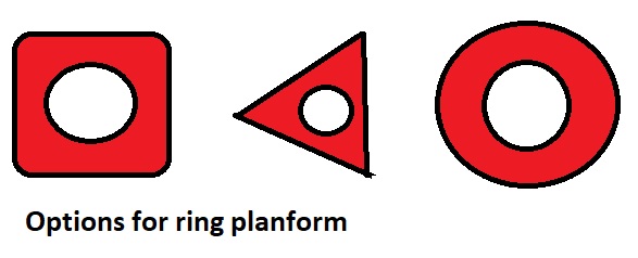

Present first version of a type will have a central ring. Attached to the central ring will be spar-compression-element flight lines that surface the inflated spar. Also, the ring will be base for kingpost and base for keel and base for TCF (triangle control frame). The ring will also base forward and rear flight lines staying the base of the TCF. The ring will stay ringing the spar case during pack and tote; the ring will form a wrap core for the spar case. Pack and tote will have the bladder stay encased in the spar case. Sail will be separated from the spar case for pack and tote. The ring will potentially root sweep-stay lines, if needed; thus the nose part of the ring will act, if needed, as a mini-bowsprit; first efforts will be without sweep-stay lines. The nose of the ring will base frontal kingpost landing line; the other KP landing line will root at the rear of the keel. The ring will be available for basing a keel rib above the keel main. The ring might be circular or triangular or square in lateral planform. The ring will attach well to the spar case to transmit torsion-control forces to the spar case.

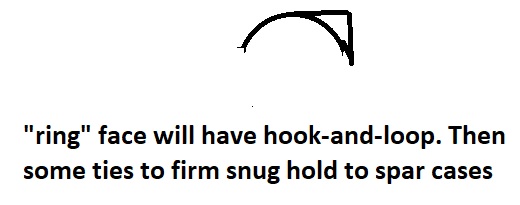

I wrote recently of "ring" being designed and showed some option planforms; progress is giving a different option of a partial "ring" that grabs just the upper portion of the spar case for foundation and torsion transfer to the spar case. Think at-most of a semi-ring, and not a full ring. For a Dockweiler Dandy early version, a semi-ring affair is winning first efforts here.

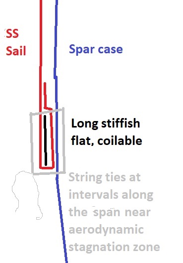

A progress for SS experimental version of a first Dockweiler Dandy Wing4 (not 5) has been made: The SS will be frontal hemmed; in the hem will be placed a stiffish flat; then at 6-inch intervals a tiny shoe-knot tie will hold down the hem-held-flat. The strings will be permanently installed in the spar case; at assembly, the ties will be threaded through a tiny hole in the sail adjacent to inner edge of the flat slat; then shoe-tie knots will be quickly tied to cause the leading edge of the sail-hem to hug the spar case. The position of the leading edge of the sail will be hopefully just below the most probable aerodynamic stagnation point of the front face of the spar case. Perhaps the stringing parts of the tie may be tucked under the sail edge hem. The weights of the interval strings and the stiffish flat will be low; time will tell. The perma-setting of the interval strings will use two poke-through-the-case holes in the spar case; the distance apart of each two-holes will match the width of the flat slat, so that the position of the slat is firmed. It is guessed that each two-hole set will be 6 inches away from neighbor two-hole sets. For 20-ft spar span: 41 stations of two-poked-holes. The poked holes will be made in the spar case using a needle threaded with the chosen string; shearing hole punch will not be used; only needle-poke holes will occur; ark hole position, pinch spar case, put needle through the pinch, cut length; after strings are set: dab puncture position with a tiny dab of appropriate glue. Notice that the spar case need not be airtight; the interior bladder will be the airtight part.
