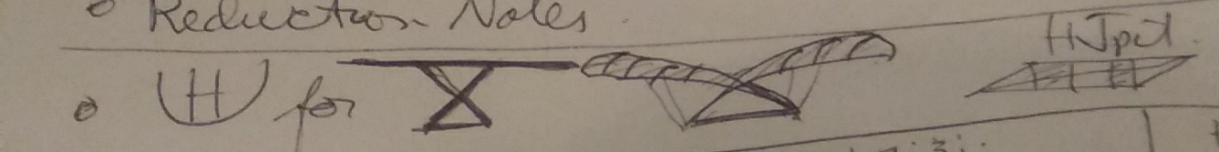

Cleaning and reducing notes, I found a small-paper jotting shown.

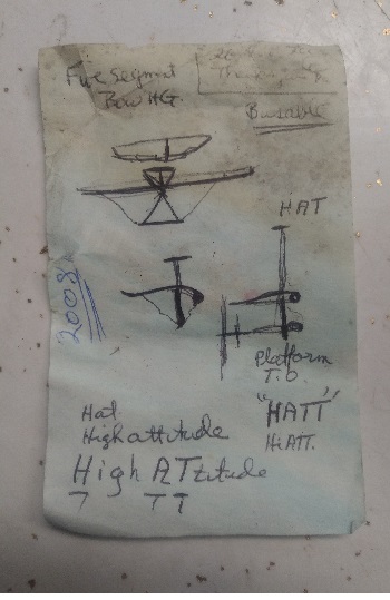

And a 2009 tiny note showing:

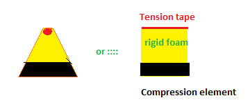

Get "light" for Wing4 pack is a target of keen interest. To achieve a Dockweiler Dandy conservative wing at Wing4 may include what I am calling now "technical beams" where beam construction fits specific stresses. E.g., where a tip beam is needed for holding sail loads, such beam need not be strong in all directions, just in the direction of holding the sail. So, the beam may have focused tension-holding structure on outboard side and compression-holding on the inboard side. Consider low-mass rigid foams separating the tension member from the compression member, and shell case the affair in a thin shell of fiberglass-epoxy or carbon-fiber-epoxy.

The tension tape in the drawing is to connect to the compression element's ends, at least. One may see such affair as a "splinted foam core" deal.
