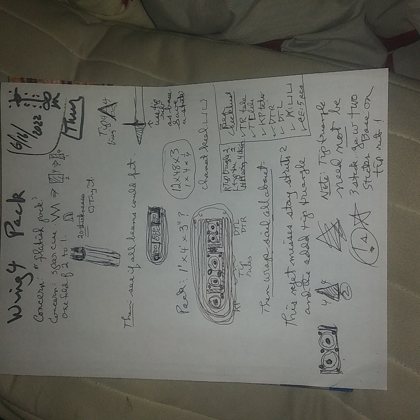

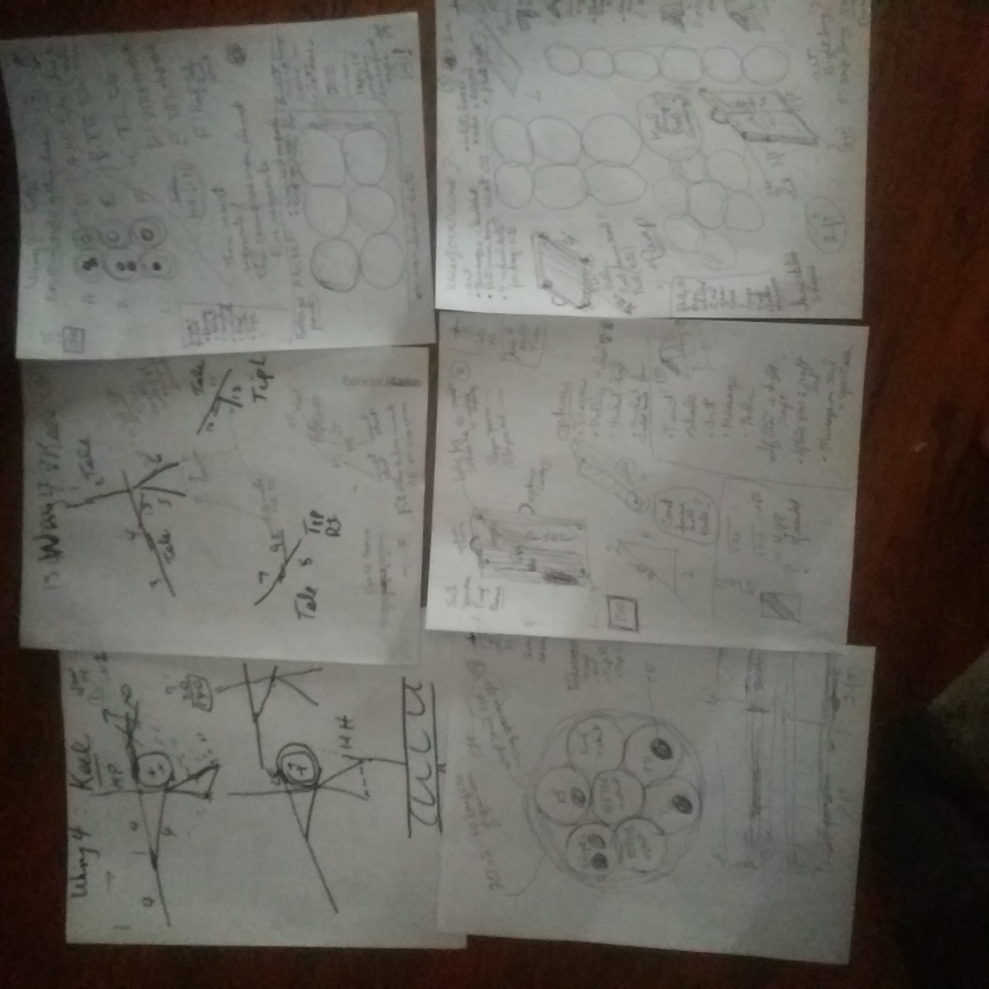

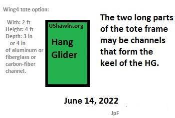

Image is not intended to be clear, but to mark a moment.
Image notes regard mostly a Wing4 pack for polite city-bus toting and wheel land trekking: Sensing 150 square feet wing for "Dockweiler-only conservative flight"
:arrow: Tote case: 4 ft by 2 ft by 1/3 ft: less than 2.7 cubic feet.
:arrow: Add four small wheels when wanted to let the tote case become an 8-sq-ft street dolly or cart on top of which may be placed added gear or self. Consider means to brake a downhill coasting cart with pilot on top of the coasting dolly/cart.
:arrow: Add four small wheels to the 2-ft bottom when holding the case vertically in the 4-ft dimension.
:arrow: Add four small wheels to the 4-ft. edge if carry from handle with 2-ft vertical hung from hand, if wanted.
:arrow: Beams of wing fit inside; spar case fits inside five layers accordion; sail fits inside folded half and then five layers. KP, TCF, CE, WTR, WTL, Keel. (king post, triangle control frame, compression element segments, wing tip right, wing tip left, keel; two-part telescopes: KP, WTR, WTL, and Keel). Couplers and line sets may be inside also. Air pump fits inside also either as a separate item or as a Bill Cummings keel-pump where the telescoping two parts are formatted to be an air pump. Not shown on the unclear image is an understood High Hat pitch assistant at top of KP.
:arrow: At site after wing is assemble: carry case optional uses: teepee tent, sign with messages, sun shade to keep water and food cool, privacy place, nap-time head cover, shade for friend, sandwich sign for ads, ...
:arrow: Alternative to wheels for tote: travois with abrading element on case edge.
:arrow: Two side handles to mimic standard luggage: two attitudes of handle carry: 4-ft tall or 2-ft tall.
:arrow: Decorate the outside of the tote case to invite visibility with an accepting polite color.... and perhaps message that would be understood: art carrier, music carrier, some innocent product carton, pleasant photograph, "Contact me about hang gliding: email....", or "Kites for Peace and Love!"
:arrow: Case and inflated spar might become water raft elements; beams and sail might give sailing to the raft.
:arrow: The unclear image shows a 7-circle suggestion for an alternative pack where an added case would not be used; but the spar case and sail wraps the 4-ft log-like tote form. At this writing, I am preferring a separate case that has alternate secondary uses.

Giving up some secondary play with the tote tool, the frame of the tote tool could be channel items for the hang glider's keel. Then, perhaps, the parts of a wing-tip could be a Bill-Cummings air pump. Have the inflating valve at the wing tip; pump the wing tip parts to inflate the spanning spar.
The tote-tool frame might arrive from some of the ladders that I have. The fill of the rectangle broad sides of the tote tool might play as wings for the High Hat subassembly and/or fins, ...

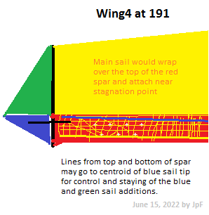

Postby JoeF » Wed Jun 15, 2022 4:50 am
Note shown has subsequently been edited, but shown is almost all of the content:

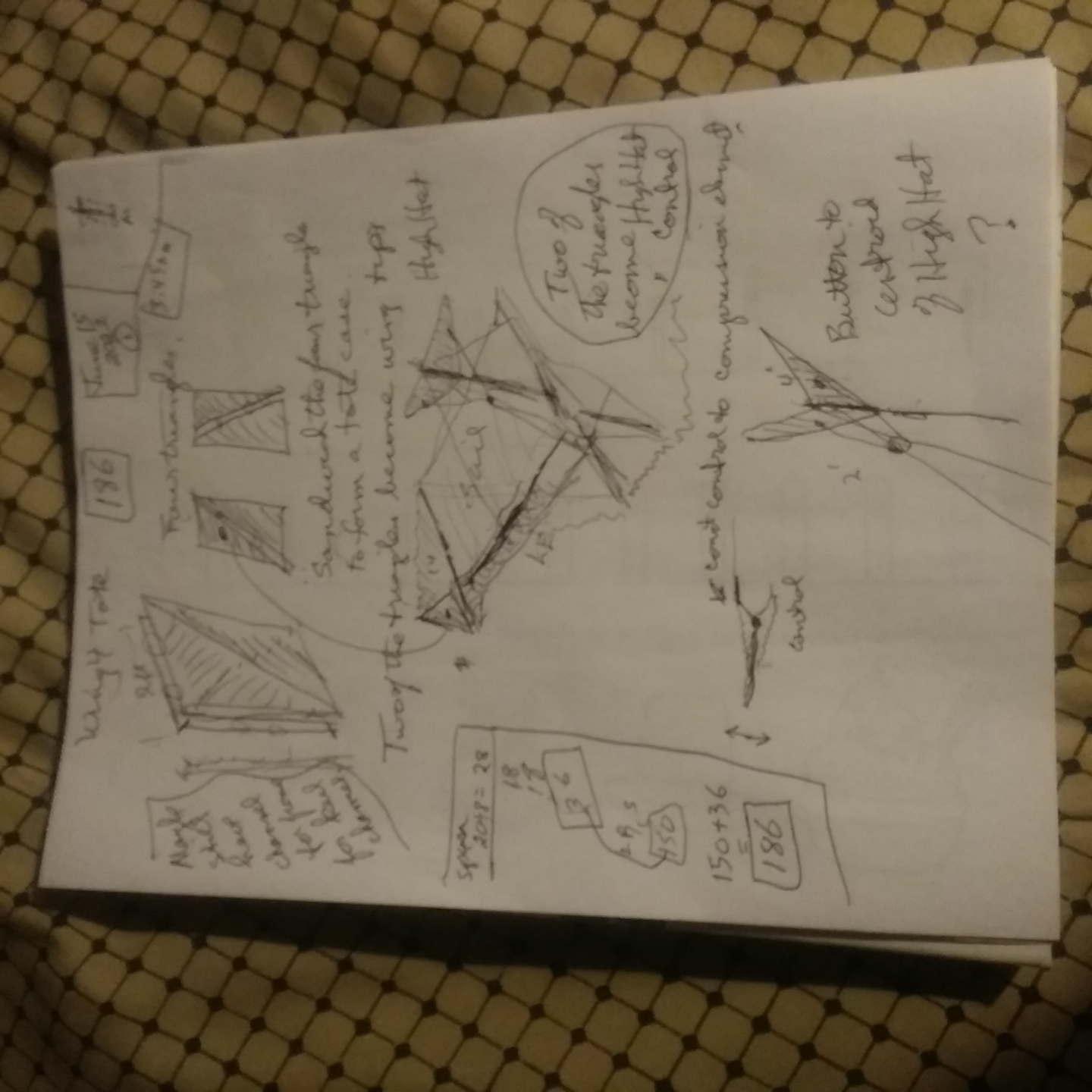

Further tote considerations may allow new wing tips for a resultant of Wing4 to about 191 sq. ft, using extant spar case. Span: [4+20+4] ft=28 ft. New projected area: 4+14+155+14+4= 191 sq ft. AR becomes about 4 via 28x28/191. And the L/D: wait to experience: :arrow: whatever.
Tip control might be by button to centroid of tip triangle.
Tip triangle could base a further sail area; and such sail addition might stay the mainsail and thus maybe preclude a stay strut that had been anticipated at the interior right angle of main long tip rib and spar case; such strut may not now be needed as the added tip triangle could found a staying tension to the long main wing-tip rib.
Tote case might have four right triangles to form the broadsides becoming the public visible sides of the toted pack. Two of such triangles for High Hat, perhaps. Two of such for new wing tips. Options of triangle fill vary from rigid foam with camber to simple sail with zero camber but with button camber control for roll and yaw---many variations may be explored. The right triangles would have legs of 4 ft and 2 ft with hypotenuse of about 4.7 ft.
The hypotenuses of the two triangles of one side of the tote package would cross the hypotenuses of the two triangles of the other side of the tote case.
Still, channel may frame the tote tool; and such channels would still be for keeling the HG.
Postby JoeF » Thu Jun 16, 2022 7:26 pm
Current bet for Wing4-184 (or so) first version will pack to a new estimate to 1x4x1/3 for a 1 1/3 cubic-foot pack at 12 inches by 48 inches by 4 inches. That would be pleasant. And such would be with the extant too-heavy spar case which I made out of too-heavy PVC jumper-house material. The spar case too-heaviness just might have a strong torque resistance asset; but future efforts will explore reducing the spar case weight from the unwanted too-heavy 11 lb situation. Attached herein is a mid-nap note made today; the note mentions "3 inches" but my estimate is that 4 inches will be the deal. Some changes from yesterday's wing-tip triangle: the triangle won't be using three sticks, but two only while basing parasitically on the long tip rib. Image of note was included for the record; sorry for any fuzziness.

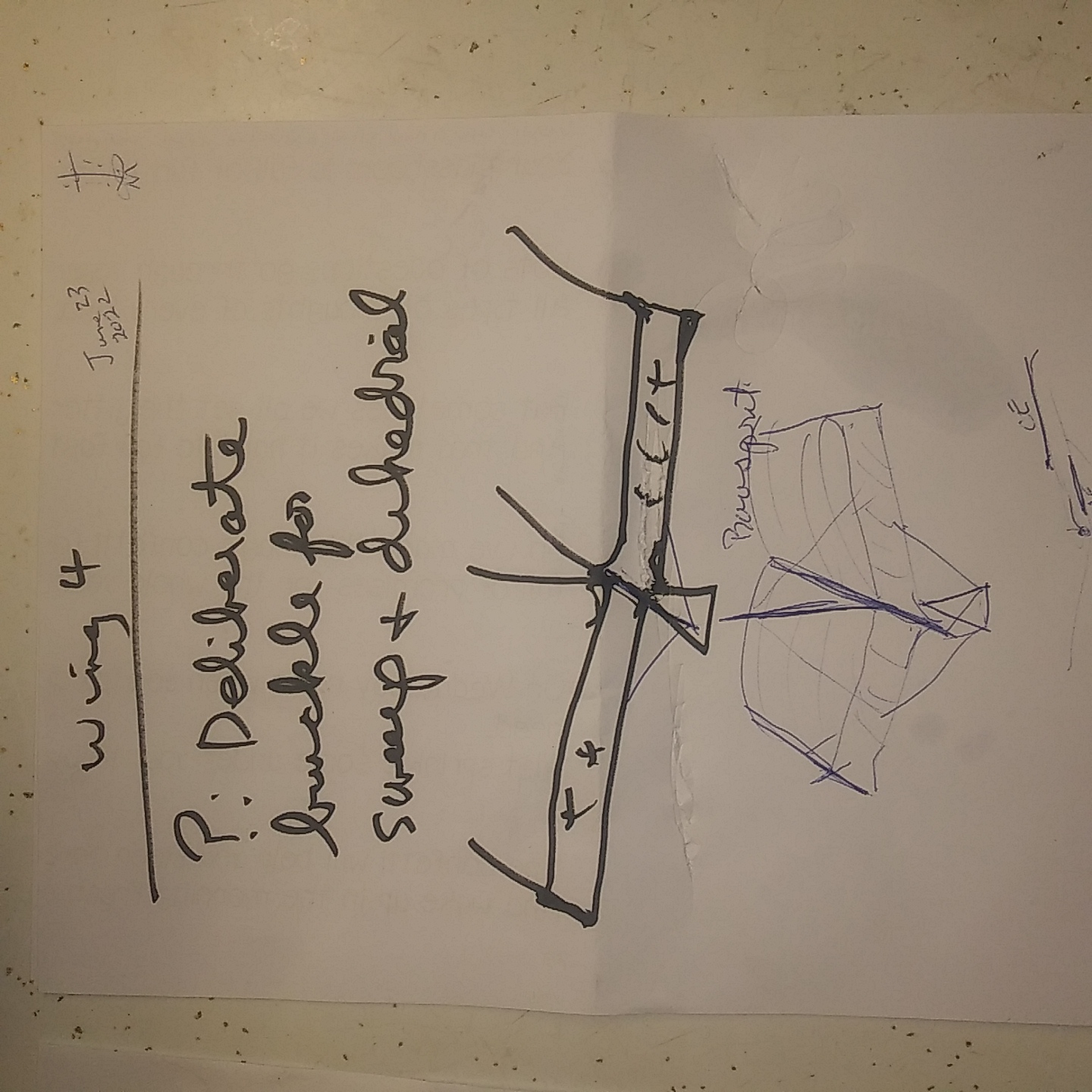

Postby JoeF » Fri Jun 24, 2022 7:11 am
Let an inflated beam be splinted with various compression members on its spar case for most of the full wing's span. But consider allowing the center be non-supported by any spar-case compression members for the purpose of deliberately buckling the the one long full span air beam; have the buckling occur by deliberate squeeze by a complex keel which keel would extend a bowsprit. Have the squeeze-buckling be set so as to provide a tip washout angle to tips of the airbeam where at the tip is a flattened closure (not bulbous closure). Allow the central buckling line result in a dihedral and sweep for the macro wing. Note that the air pressure of inflation will be equal on the left and right portions of the wing's main spar as full communication of inflation air persists despite the chosen buckling.
