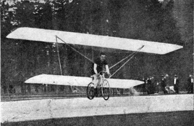

Postby eagle » Tue May 24, 2016 11:08 am
Gabriel Poulain on his record-setting run.
Earned him the Peugeot Prize for human-powered flight on July 9, 1921. (Source: Flugsport, Aug. 17, 1921)
See News: http://generalaviationnews.com/2011/04/ ... g-bicycle/
