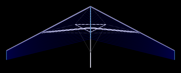

Postby Chris McKeon » Fri Oct 08, 2021 6:39 pm
1: 234" 2: 117" 3: 142" 4: 24" 5: 206" 6: 63" 7: 70" 8"57" 9: 60" 10: 60" 11: 32"
15: 48"
Re: Predator Model
Postby Bob Kuczewski » Sat Oct 09, 2021 1:10 am
Chris McKeon wrote:1: 234" 2: 117" 3: 142" 4: 24" 5: 206" 6: 63" 7: 70" 8"57" 9: 60" 10: 60" 11: 32"
15: 48"
Good progress Chris!!
But there are a few things "Abby Normal" about those measurements:
#Name Value     Description
1Length of Leading Edge234"Length of the leading edge from nose to tip
2Length of Keel117"Length of the keel
3Keel Front y142"Distance from the origin to the front tip of the keel
4Keel Rear y24"Distance from the origin to the rear tip of the keel
5Wing Tip x206"Distance from the origin to the right wing tip
6Wing Tip z63"Vertical distance between the origin and right wing tip (this might be hard to measure, so just estimate it)
7Control Bar Height70"Vertical distance from the base tube to the keel (perpendicular distance from the keel to the base tube)
8Control Bar Width57"Width of the base tube from corner to corner
9Control Bar Location60"Distance along the keel from the nose to the apex of the control frame
10Control Bar Rake60"Horizontal distance along the keel from the apex of the control frame to the base tube (this may be hard to measure, so just estimate it)
11Cross Bar at Leading Edge32"Distance along the leading edge from nose to cross bar junction where the cross bar meets the leading edge
12Cross Bar at Keel        Distance along the keel from the nose to the cross bar where it crosses the keel
13Cross Bar z from Keel        Vertical distance between the keel and the cross bar (typically 0 to a few inches)
14Kingpost at Keel        Distance along the keel from the nose to the kingpost (you can also measure from the rear of the keel and subtract from the keel length)
15Kingpost Height48"Vertical distance (perpendicular to keel) from the keel to top of the kingpost
16Kingpost Rake        Horizontal distance (parallel to keel) between top and bottom of kingpost
17Trailing Edge        Distance along the keel from the nose to the trailing edge of the sail
18Rear Wire        Distance along the keel from the nose to the rear wire where it attaches to the keel
First, the Keel Front y plus the Keel Rear y should equal the Length of Keel:
Length of Keel=Keel Front y+Keel Rear y
117"=142"+24"
But    117    does not equal    142 + 24    so something is wrong there.
Also, number 11 should be the "Distance along the leading edge from nose to cross bar junction". It's hard to believe that's only 32 inches. So please recheck that measurement.
But you're making progress, and that's the most important thing!!    :thumbup:
Re: Predator Model
Postby Bob Kuczewski » Thu Dec 09, 2021 1:00 am
That last post was from October 9th, 2021. Unfortunately, Chris sustained an unrelated injury at that time, and we didn't finish the Predator Model.
Also, I think I may have made a mistake in my analysis of the measurements. Chris had posted values of 142 and 24 which didn't add up to 117. However, if 24 is subtracted from 142, then the answer is 118. That's pretty close to 117, so there may just be a sign interpretation difference in that measurement. We'll have to reconfirm those numbers.
Since that time, we've also gained a new member of the U.S. Hawks from the Rio Grande Soaring Association. Finis appears to have done a lot of work with Blender, and I am hoping that he can lend a hand with some of our computer modelling efforts. This will be most helpful for the training manual which has been on hold for quite some time.
Until then, let's see if we can get (or estimate) the final measurements to finish the Predator model.
I think this is the current JSON model:
'Version': 1.0,
'KeelFrontPoint': [0,94,0],
'KeelRearPoint': [0,-119,0],
'WingTipPoint': [291,-60,6],
'TrailingEdgePercentKeel': 52.5821596244,
'RearWirePercentKeel': 75,
'ControlBar': {
'Height': 65,
'Width': 107,
'ApexPercentKeel': 42,
'RakeDistance': 27,
'CrossBar': {
'PercentKeel': 35,
'PercentLeadingEdge': 59.0060240964,
'HeightAboveKeel': 7,
'KingPost': {
'PercentKeel': 42,
'Height': 50,
'RakeDistance': 3,
'Battens': {
'NumPerSide': 2,
'BattenList': [
'PercentLeadingEdge': 0,
'Segments': 20,
'LeadingEdge': [50,165],
'LeadingEdgeControl': [125,20],
'TrailingEdgeControl': [275,150],
'TrailingEdge': [685,160]
'PercentLeadingEdge': 100,
'Segments': 20,
'LeadingEdge': [225,305],
'LeadingEdgeControl': [240,295],
'TrailingEdgeControl': [283.5,297.1666717529297],
'TrailingEdge': [404.5,318.1666717529297]
If you copy and paste that into the "Glider Data (JSON format)" window of the modeling program (at https://ushawks.org/designer), and click "Update Model From Text" button, and then set the "Zoom" to 1.0, you should get this image:
That's pretty close, but it's not complete yet.
I've written two Python programs to help with this project. They convert between the measured format (the table that Chris has been filling out) to the JSON format shown above in this post.
Here's the Python program that converts the Raw Measurements to the JSON model:

It's a pretty simple program, and the data is all hard-coded. The variables are reassigned several times before doing the actual calculations, and only the last set counts. The earlier values are just there for documentation of those models.
While that version builds a model from measurements, I also wrote a program to generate "measurements" from a model. This was mostly used to confirm that the earlier program worked properly, but it may have other uses. Here's the code:
import math
# This is the standard glider model
Standard_Model = {
'Version': 1.0,
'KeelFrontPoint': [0,5,0],
'KeelRearPoint': [0,-5,0],
'WingTipPoint': [15,-3,0.2],
'TrailingEdgePercentKeel': 80,
'RearWirePercentKeel': 82,
'ControlBar': {
'Height': 3.5,
'Width': 3.2,
'ApexPercentKeel': 40,
'RakeDistance': 1.0,
'CrossBar': {
'PercentKeel': 33,
'PercentLeadingEdge': 60,
'HeightAboveKeel': 0.1,
'KingPost': {
'PercentKeel': 40,
'Height': 3,
'RakeDistance': 0.1,
'Battens': {
'NumPerSide': 2,
'BattenList': [
'Segments': 20,
'LeadingEdge': [50.0,165.0],
'LeadingEdgeControl': [125.0,20.0],
'TrailingEdgeControl': [275.0,150.0],
'TrailingEdge': [685.0,160.0]
'Segments': 20,
'LeadingEdge': [225.0,305.0],
'LeadingEdgeControl': [240.0,295.0],
'TrailingEdgeControl': [260.0,300.0],
'TrailingEdge': [350.0,315.0]
# This is a "pixel scale" model of a Predator from photo
# This model should use a "Zoom" of around 1.5 to fit
# This model has a shifted origin (by 60) to rotate nicely.
Model = {
'Version': 1.0,
'ControlBar': {
'Height': 65,
'Width': 107,
'RakeDistance': 27,
'CrossBar': {
'PercentKeel': 35,
'KingPost': {
'PercentKeel': 42,
'Height': 50,
'RakeDistance': 3,
'Battens': {
'NumPerSide': 2,
'BattenList': [
'Segments': 20,
'Segments': 20,
# Convert from dictionary to named variables
KeelFrontY = Model['KeelFrontPoint'][1]
KeelRearY = Model['KeelRearPoint'][1]
WingTipX = Model['WingTipPoint'][0]
WingTipZ = Model['WingTipPoint'][2]
TrailingEdgePctKeel = Model['TrailingEdgePercentKeel']
RearWirePctKeel = Model['RearWirePercentKeel']
CtlBarH = Model['ControlBar']['Height']
CtlBarW = Model['ControlBar']['Width']
CtlBarPctKeel = Model['ControlBar']['ApexPercentKeel']
CtlBarRake = Model['ControlBar']['RakeDistance']
CrossBarPctKeel = Model['CrossBar']['PercentKeel']
CrossBarPctLE = Model['CrossBar']['PercentLeadingEdge']
CrossBarZ = Model['CrossBar']['HeightAboveKeel']
KingPostPctKeel = Model['KingPost']['PercentKeel']
KingPostH = Model['KingPost']['Height']
KingPostRake = Model['KingPost']['RakeDistance']
# Generate additional scalar values
LenKeel = KeelFrontY - KeelRearY # Note that KeelRearY will normally be negative
LenLE = math.sqrt ( (KeelFrontY * KeelFrontY) + (WingTipX * WingTipX) )
# Convert from percent values to scalar values
CtlBarLoc = CtlBarPctKeel * LenKeel / 100.0
CrossBarLE = CrossBarPctLE * LenLE / 100.0
CrossBarKeel = CrossBarPctKeel * LenKeel / 100.0
KingPostKeel = KingPostPctKeel * LenKeel / 100.0
TrailingEdge = TrailingEdgePctKeel * LenKeel / 100.0
RearWire = RearWirePctKeel * LenKeel / 100.0
# Print the scalar values as measured values
def ft_in_from_ft ( ft ):
return [int(ft), int(100*12*(ft-int(ft)))/100.0 ]
print ( "LenLE_Meas = " + str(ft_in_from_ft(LenLE)) )
print ( "LenKeel_Meas = " + str(ft_in_from_ft(LenKeel)) )
print ( "KeelFrontY_Meas = " + str(ft_in_from_ft(KeelFrontY)) )
print ( "KeelRearY_Meas = " + str(ft_in_from_ft(-KeelRearY)) )
print ( "WingTipX_Meas = " + str(ft_in_from_ft(WingTipX)) )
print ( "WingTipZ_Meas = " + str(ft_in_from_ft(WingTipZ)) )
print ( "CtlBarH_Meas = " + str(ft_in_from_ft(CtlBarH)) )
print ( "CtlBarW_Meas = " + str(ft_in_from_ft(CtlBarW)) )
print ( "CtlBarLoc_Meas = " + str(ft_in_from_ft(CtlBarLoc)) )
print ( "CtlBarRake_Meas = " + str(ft_in_from_ft(CtlBarRake)) )
print ( "CrossBarLE_Meas = " + str(ft_in_from_ft(CrossBarLE)) )
print ( "CrossBarKeel_Meas = " + str(ft_in_from_ft(CrossBarKeel)) )
print ( "CrossBarZ_Meas = " + str(ft_in_from_ft(CrossBarZ)) )
print ( "KingPostKeel_Meas = " + str(ft_in_from_ft(KingPostKeel)) )
print ( "KingPostH_Meas = " + str(ft_in_from_ft(KingPostH)) )
print ( "KingPostRake_Meas = " + str(ft_in_from_ft(KingPostRake)) )
print ( "TrailingEdge_Meas = " + str(ft_in_from_ft(TrailingEdge)) )
print ( "RearWire_Meas = " + str(ft_in_from_ft(RearWire)) )
As with the other program, this program contains several "hard-coded" models, and only the last one is actually used in the computation.
