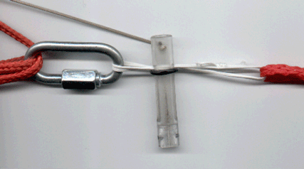

Here's an animation from that page:
Any comments?

02. The animation depicts a Hewett Bridle. Anyone using a Hewett Bridle doesn't have a clue regarding the basic physics of hang glider towing (or kite flying).
03. Tell me what the Linknife accomplishes more effectively than the Schweizer releases Dave Broyles and others were incorporating in their tow systems in the early Seventies - without having to cut and replace anything each flight.
A. The Linknife is MUCH lighter so if/when a snap-back happens, it won't put out an eye (ala Michael Robertson).
B. Using a new weaklink for each flight helps assure that it won't break prematurely, as the Reel Pilots experienced in the mid- and late-80's when we used a single weaklink many times.
C. By having the release well in front of the wires, there's nothing to snag, especially if in the middle of a lockout to the side.
D. The best: No tow forces are placed on the Linknife but rather go through it... the more tension there is, the faster it cuts with no additional effort required to release.

A straight base tube is better than a speed bar for static towing. The bridle has less of a chance of locking in on one side of a speed bar. (Just a suggestion)
Yeah Peter, just a suggestion that no one in Europe has absolutely no reason to make or hear.
Note that bridle hang-ups on grips and basetube mounted hardware have locked out, mangled, and killed people.

11. He's cutting the weak link. What's the purpose of the weak link?
Tad, if you have to ask the question at this point, you have no business taking notes.
VERY high towline forces and an over-the-top lockout. You'll have both hands on the basetube pulling it well past your knees but the glider doesn't come down and still the weaklink doesn't break (.8G).
Apparently to blow you off tow when you can't get to your Linknife lanyard in the course of an over-the-top lockout.
And somebody ask Peter how it's possible to experience "VERY high towline forces" with a 0.8 G weak link - the FAA's MINIMUM legal rating for the MAXIMUM certificated operating weight of the glider. (The maximum legal for US sailplanes and hang gliders is 2.0.)
I see you are still trying to pawn off on someone else what you can't do yourself. Fuckin' coward... ignorant coward.
12. How is the Linknife being configured? What happens in an Eric Aasletten scenario (Performance Flying - Page 259, Figure 10-15) when Peter's clever little "Pitch & Lockout Limiter"...
http://www.birrendesign.com/LKOpinions.html
...kicks in?
Tad, you ignorant slut, if you read further than your selective snipping reaches to somehow prove a point, you would have read how this works. And, pray tell, what is the title of that page? Could it be "opinion"? as in a thought/idea. Surprising, isn't it, that I've heard from a couple of instructors (both with more credibility in their little fingers than you have in your self-inflated ego) who have been using similar systems for years to prevent hazardous scenarios from happening... and it works. But you'll never consider what actually works, just your own concepts of reality.
Peter Birren - 2009/05/09
If you want a truly foolproof release, it's got to be one that eliminates the pilot from the equation with a release that operates automatically.
Sorry Peter, a person on a glider who gets eliminated from the decision making and control equation isn't a pilot. If he's lucky he's a passenger. If not he's an item on the eleven o'clock news.
I can blow six hundred pounds of towline tension with about an eleven pound pull to a keel mounted barrel release - WITHOUT taking my hand off the basetube. I can live with that - thank you very much.
These are the first I've heard of these problems... both easily preventable.
Yeah, they're easily preventable. They're also problems that my stuff and the Koch don't have.
