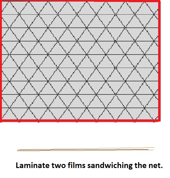

Triangled-mesh net as a basis for a ripstop low-mass sail? Laminate a low-mass fabric or low-mass plastic sheet to the triangled-mesh net.
What might be commercially available in such kind of netting? Maybe a workaround: bond two flat nets to each other after turning one net at 45 degrees to the other first net?
DIY net and then DIY lamination? Dyneema line for the triangulated mesh? Triangles of 6 inch sides? How to form the net junctions? Superglue?
Postby JoeF » Tue Jun 28, 2022 6:51 am
DIY net of Dyneema string?
Most common nets are quadrilateral or hexagonal celled. One found "triangle" celled net seems actually to still be quadrilateral when fine investigation is done. So, DIY net suggested itself. If one started with a commercial product net of quadrilateral cells, then one possibility is to add string lines to form diagonals to the cells. But I am after a large celled net with triangles about 6 inches on each side; and I want to avoid knots in the base net. Aim is low mass for the HG sail. I want the string net to transfer the cell flight loads; having one cell be so isolated will permit using thinner sail material for each cell.
Let the equilateral triangle cells be about 6 inches for each side. The junctions are three-string stacks and thus the valence at the junction is six. The stack of three strings could be sewn; mark the joins while the strings are in light tension; use the marks to hand sew the joins by using a small fid to end the three strings marked at the join; find a satisfactory closing knot for the join; cut off excess joining thread; maybe dab the join with silicon, not sure yet. While the perimeter of the macro net could be a light webbing, a holding frame might be used to facilitate lamination of thin-film Mylar; envisioned is a sandwich of two Mylar films that have the string net sandwiched.
Mods of the above?
Consider other-than-Mylar to form infill of the triangle cells. The triangulated net will be carrying flight loads to the HG frame. Reuse of film materials found discarded in cities? If bonding captures the string edges of one triangle cell, then the flight loads of the small triangle cell will permit use of even thin paper. Fun to explore! Loss of some sail in some cells won't be catastrophic at Dockweiler. Patching might be easy; glue some notebook paper to the vacated triangle cell? Collect all those birthday and graduation Mylar balloons from the city's bushes; cut patches of the balloon film and in-fill the triangle-cell net.
https://keisan.casio.com/exec/system/1223266946 One cell will hold about 16 sq in of sail. Very rough envisioned load: 3 oz per cell's area; so, if a cell's sail can hold say 5 oz without burst, then game is on; ruptures will occur, but can be patched.
Back-of-napkin rough: 10x20=200 sq. ft. 200x144/16=1800 cells. 250 lb/1800 cells= ..... approx 3 oz per cell flight load, rounding up for safety factor.

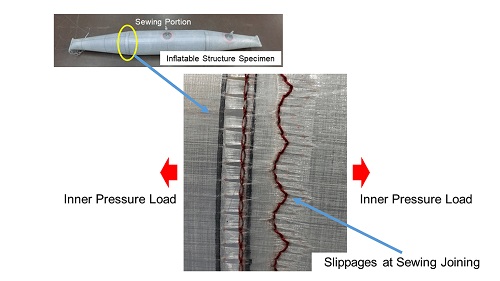

https://www.toyota-global.com/innovation/partner_robot/news/202201_01.html
The Mothership Project
Toyota Frontier Research
The fibers appear to me to be Dyneema.
Take special care to note their progress in making a new base woven fabric.
"Image 6: Comparison of the conventional and new base fabrics: because it is woven, the new base fabric has a uniform density"
I do not see splinted tactics, only high pressure; I see dependency on inflation without splinting. But, maybe they did splint compression members; maybe not.

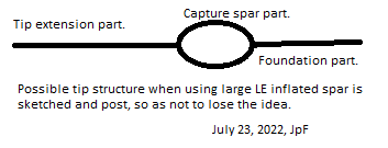

Postby JoeF » Sat Jul 23, 2022 9:42 pm
Not much to say on following yet:

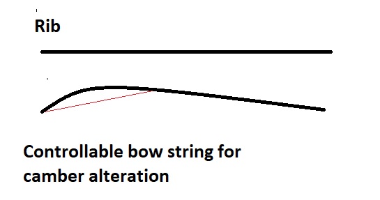

Postby JoeF » Mon Jul 25, 2022 8:31 am
Muhonen Adjustable Ribs
Adjusting method options?
:arrow: Wireless? Voice-activated? ???
:arrow: Control line to pilot? Helmet, hands, torso, tether,
:arrow: Locally passive-reactive?
:arrow:
Brainstorm methods of adjusting the form of the rib:
:arrow: Shorten rib
:arrow: Lengthen rib
:arrow: Alter curvature of rib
:arrow: ?
A first effort: "camber by way of a controlled-length bow string"
