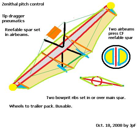

Designing toward short-pack HG with some Safe-Splat.
High-hat pitch control.
Toward Dockweiler Handy family ...
2008 designing toward short-pack HG with some Safe-Splat hinted

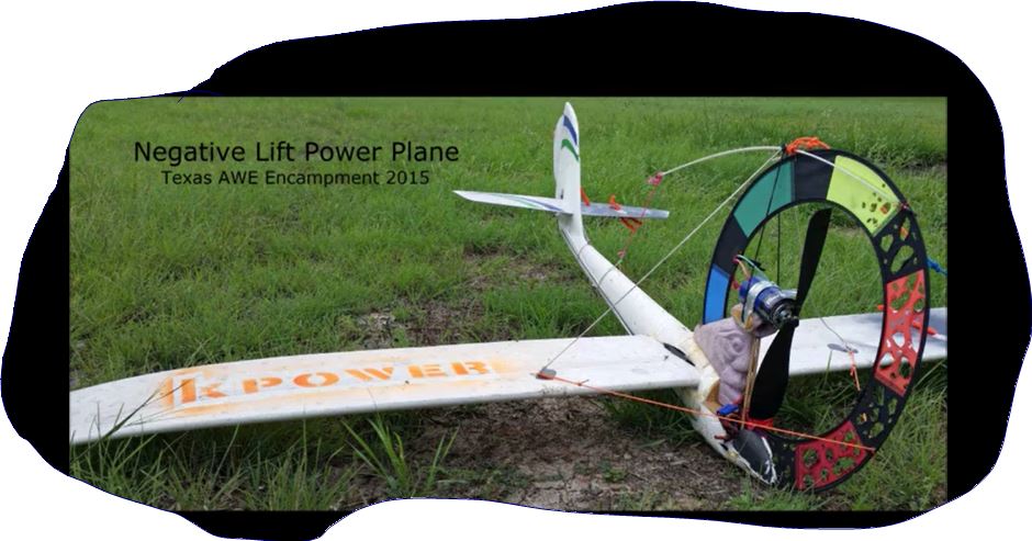

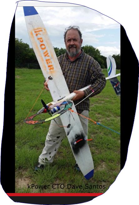

kPower demonstrated a device that might involve a Safe-Splat ring:
Re: Safe-Splat
Postby Frank Colver » Thu Jul 02, 2015 12:14 pm
Some people have too much time on their hands :!:
