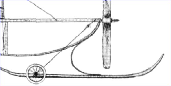

Wheels and ski
And a different time and place and device: Notice the spring.
http://fly.historicwings.com/wp-content/uploads/2013/03/HighFlight-Models2.jpg
... same as link, but partial clip showing here:

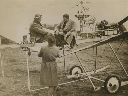

The Keith Weiss Aviette of 1912 with accented anti-whack
http://www.ctie.monash.edu.au/hargrave/weiss.html
http://www.ctie.monash.edu.au/hargrave/ ... weissA.jpg
http://www.modelflight.regheath.com/ear ... Platel.jpg

Along these lines I present more (attached rough sketch); this regards triple purposing a mini-canard that flys for lift to partake of the flying performance of the HG, but acts as a low spoon-like sled that slides over brush and boulders; Teflon(R) lower surface comes to mind. A triple purpose would be the use of the spaces of the canard: exterior top for data, notes, plans …data deck streamlined into the upper surface. Lower surface could purpose for communication by illumination, perhaps more. Interior might double for storage of first-aid, water, batteries, tree-out thread, food, oxygen; maybe pod could be more streamlined as some things are moved to the canard-spoon-anti-whacker wing interior; with upper surface as screen, perhaps TCF braketed instruments could be deleted and a streaming savings there; but these are extras). At TCF base a set of skis in drawback positioning could be part of knuckle protection …wide enough to outperform cutting narrow wheels of sharpen tangency.
http://energykitesystems.net/Lift/Whack ... canard.jpg
http://www.energykitesystems.net/Lift/i ... ngSkid.jpg
http://youtu.be/6gq4kBzIaCs
I am considering Kevlar composite for the lower surface of the canard wing skid or sled. An a streamlined stay strut from nose to CWS is being considered (even perhaps rotatable for yaw tweaking).
