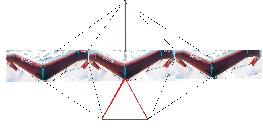

Postby JoeF » Sat Sep 10, 2022 4:12 pm
https://en.wikipedia.org/wiki/Vectran
https://en.wikipedia.org/wiki/Kuraray
https://www.alpackaraft.com/
Watch MOQ and shipping at Alibaba. Enticing pricing; experience with purchasing with Alibaba may be a preamble challenge.
Biplane mention is interesting.
In resonant spirit: >> >>?? One deck, but two wings rigged using KP and TCF queen posting. How about rigging three wings to have HG: left, central, right? Pack weight and pack volume grows ... Perhaps add compression beams to the commercial wings?
Pack weight
Pack volume
Pack shape
Wing area
Repair logistics
Auxiliary equipment
Rigging or not
