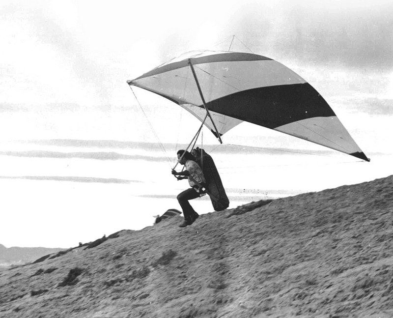

Neil Larson recently reminded the world of the pioneering display of Eddie Paul (RIP).
Note the HG carrying a HG carrying a HG: (triple)
Showing the wing is not a recommendation; the cable-LE: caution.

It is not clear of the length of Eddie's pack; is it 5 ft or more?
