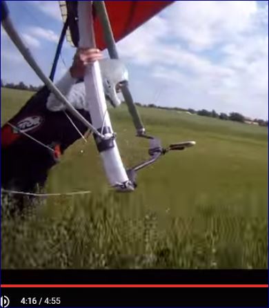

Bob Grant noted about landing in wheat fields:
"That wheat can really grab your base bar quickly" and examples with a video
Go to the 4:00 station in the video for quick start on topic.
Concern over the "safe splat" question over the matter may be valuable.

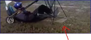

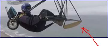

Bright Star Swift version.
[ Safe-Splat ]
Note: Swifts have appeared with various frontal items from bare raw tubing fronts to wheels to skids to inclines.
I do not know if the clip is a spoon-like item or not.
Is that epoxy fiberglass covering some base core material?

Re: Safe-Splat
Postby brianscharp » Mon Aug 24, 2015 8:21 am
Pictured is a plywood skid.
Your edit poses a new question.
That might be a lighter design, but plywood was used. I can't be certain the one pictured is not some modification, but I doubt it.
Off topic though, the major modification I noticed was the addition of rudders.
brianscharp
Posts: 304
Re: Safe-Splat
Postby JoeF » Tue Aug 25, 2015 9:16 am
Brian, thanks. Maybe the shown is a part cored with plywood and finished with fiberglass-epoxy.

Re: Safe-Splat
Postby brianscharp » Tue Aug 25, 2015 10:24 am
Maybe, but mine and the others I've seen are simply a high grade piece of plywood with no finish.
brianscharp
Posts: 304
Re: Safe-Splat
Postby JoeF » Tue Aug 25, 2015 11:08 am
Different Swift clip. Unknown materials for the skid:
