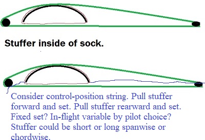

Postby JoeF » Thu Oct 13, 2022 10:49 am
Wing stuffers' positions may be set by a string to the leading edge (LE) in some HGs. Also, consider having the position-keeping string be continued to the (TE) trailing edge or nearly so. Between flights a stuffer could be pulled forward or rearward. Results are invited to be described by anyone. Wing stuffers may be designed to fit special purposes.
Variable camber ...

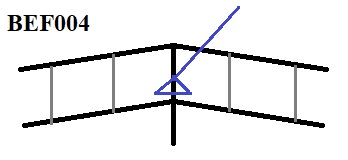

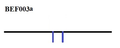

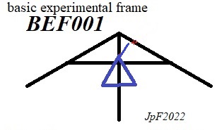

Postby JoeF » Thu Oct 13, 2022 11:05 am

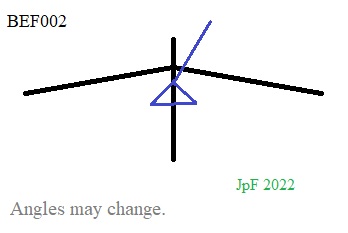

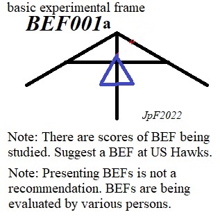

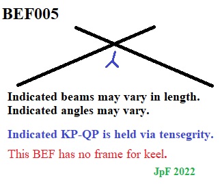

Symbols for a BEF allow instances of use to vary angles and position of KP-QP. Indicated frame members may be among many choices.
BEF001
With kingpost.
BEF001a
Without kingpost.

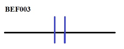

BEF002
BEF003
BEF003a
This has no KPs, but only QPs.
BEF005
Anyone may post a BEF or a suggestion for one or more.
BEF show frame elements and relative joins. A HG would be analyzed to be an expression of some BEF, perhaps a BEF that has not yet been published in the forum. Ultimate count of BEFs published is unknown. To the moment seven BEFs have been published (one of which was a named BEF003a indicating a cousin deal, a dropping of KPs and leaving only QPs.
:wave: There is no guarantee that any particular BEF has been used for any satisfactory built-and-flown hang glider. Recall that a BEF may be expressed within many HGs despite the choices of angles, sails, lines, control lines, relative position of frame joins, additions or appliques, High Hats, Safe-Splats, wing-sail stuffers, wing-sail appliques, winglets, rudders, tails, choices of material specifications for beams or any part. However, find a satisfactory HG and wonder what BEF is playing in that HG; if no publish BEF lives in the HG, then consider forming a BEF for that HG and publish that BEF in US Hawks forum. :clap:

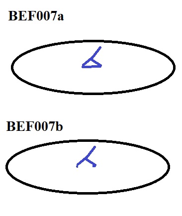

Postby JoeF » Fri Oct 14, 2022 7:06 am
"TCF" :: triangle control frame
BEF006a
TCF has beam as base element.
BEF006b
TCF has only tensed cord as base, not a beam.
BEF007a and BEF007b
The symbol for BEF700a or BEF700b shows an oval;
but in practice iterations of experiment could use
any ellipse where the circle could be an instance of an oval.
The frame part: the suggestive ring of the symbols.

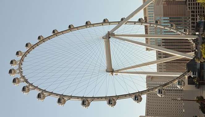

https://en.wikipedia.org/wiki/Circular_wing
https://www.nevingtonwarmuseum.com/lee- ... lider.html
https://en.wikipedia.org/wiki/Ferris_wheel
https://en.wikipedia.org/wiki/High_Roller_(Ferris_wheel)
Mulling DS HG using BEF007b and stuffer elements. The frame ring: could it be of segments of CFRP? Or splinted inflated torus ring? Judicious rigging could give reflex for pitch stability. Note that there is opportunity for captive-arch mechanics plus captive-ring rigging via Kp-Qp. Both annular and ring formats may be explored. Pilot could hang below the wing in either formats. Aim is to have a pleasant resulting empty weight while having a tiny pack fitting this topic's limits.

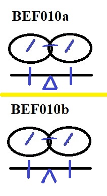

BEF010ab
The abstract drawing for the BEF010ab includes stylized skyview and a front view. Recall that the BEF symbols allow angle and length variation in real material instantiation; line rigging is not placed in BEF symbols. And a plethora of options to "dress" a BEF remain to have multiple experimental hang gliders. The target is to dress a BEF and have the frame parts so that a handy tiny pack occurs where maximum length is 5 ft or less.
BEF010ab specializes in stabilizing hoops via stay lines to a beam askew from the hoop "plane", perhaps perpendicular to the hoop "plane" but not necessarily perpendicular. The"plane" is in quotation marks because it is possible to rig and stay a hoop without resulting in a geometric plane. The interior of the hoop would be filled with various options, not necessarily filling all the interior space. And the filling of the hoop interior space could be with single sail or double sail. Dressing a BEF could include winglets, High Hats, Safe-Splats, control devices, stuffers, or more. Finally, the BEF010ab symbol show rings that look circular; instantiations of BEF010ab may distort the hoop to non-circular forms.
The "b" does not have a base frame beam for TCF; rather the "base" would be a cord or cable, perhaps with a thickening as needed; or BEF010b might have control queenpost hard framed to the wing frame.
=============== :arrow: :arrow: Notice that BEF010ab is quite different from BEF007.

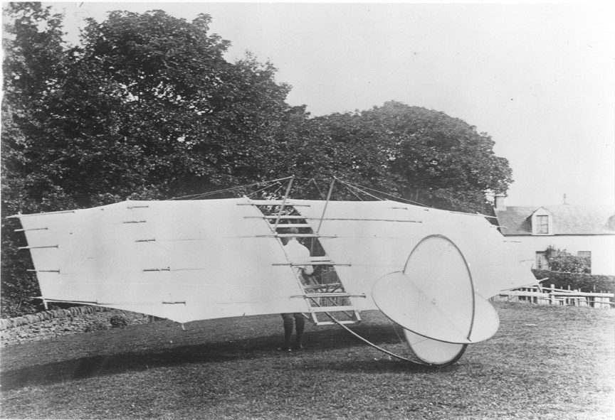

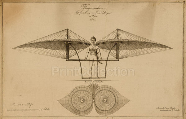

The Beetle is interesting; Percy Pilcher had more than one version of hang glider. The Beetle has distinct beams for empennage, and thus might not be an instantiation of BEF010; we seek a BEF symbol for such as the Beetle.
This not using BEF010
But the following image comes close to being with the abstract BEF010 but not exactly, probably because the shown seems to be a dynamic ornithopter rather than a hang glider; and there are beams way different from TCF.
https://www.printcollection.com/files/1 ... rande.jpeg
