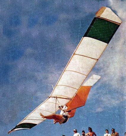

fcolver wrote:Ah, remember Bob Lovejoy's Hightailer? I think he was achieving the necessary ground clearance for a Quicksilver type HG. However, it never went into production and the Quicksilver did, so maybe it didn't provide enough pitch stability. Personally, I don't know the reason but Dave Cronk might.
FC
I don't remember hearing about it's flying characteristics. I've also wondered how effective the rudders could have been so close to the root.

Postby Frank Colver » Thu Aug 20, 2015 9:07 pm
Here is Dave Cronk's reply about Lovejoy's Hightailer.
FC
Hi Frank,
The Hightailer was a very cool-looking glider, but it had several fundamental problems:
• The short coupled wing/horizontal stabilizer made for marginal pitch stability and very sensitive pitch control. Basically it was dangerous.
• The short-coupled vertical stabilizers gave very poor yaw control. As this is a yaw/roll coupled design, roll control and stability were marginal at best.
• The triangle bar and bracing elements created a 4-bar linkage that was structurally unstable.
I convinced Bob to add a conventional tail arrangement that was perhaps mundane, but this eliminated the problems listed above. The rest is history.
The Quicksilver always required a tail-man, and that was a major drawback for foot launching. The tail man could make or break the launch, so I always tried to have someone along who knew what they were doing.
I can give a more detailed history if you think there is interest.
Hope all is well, hope to see you in the SW this fall.
Cheers,
Dave
