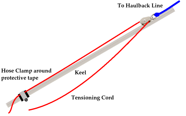

I didn't have time to add an explanation to my earlier post with the pulleys, so here it is:
I would wrap some protective tape around the keel aft of the rear wire attachment point. Then I would use a simple hose clamp to clamp a light cord to the keel (with appropriate protection for the cord). I would tie a small pulley (like one of the one's listed earlier) to the haul-back line. Pass the rope from the hose clamp through the pulley and back toward the rear of the keel. This will give you a 2 to 1 advantage when hauling back. But more importantly, it will let you tension it to some degree and then tie it off so the sail can "relax" at that new tension. Then after a few hours, add some more tension and tie it off again. Here's a sketch of what that might look like:
This drawing doesn't show it, but you might want to tie the loose end (aft of the hose clamp) back to the line running from the clamp to the pulley so it doesn't get away if it slips through the hose clamp. You might also add a small loop at that point to tie off the free end of the tensioning cord.
Now you could add more pulleys to gain greater mechanical advantage (3 to 1, 4 to 1, ...), but I think the 2 to 1 sketched here should be sufficient for a sail that's just a bit too tight. More importantly, the 2 to 1 advantage is less likely to break anything!
And speaking of breaking things, this setup gives you the ability to tie off the tension so you can inspect for where anything might be binding. I would do that initially with practically no tension. When you're sure that nothing else is binding (misrouted wires for example), then you can begin to slowly increase the tension as I've mentioned above.
Be sure that you do this in a safe place where the glider is properly tied down so it doesn't get away and damage itself or anything else.

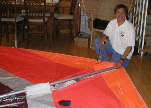

By the way Joe, while I was looking for that Little Hawk link, I found this photo:
Please notice what I'm holding in my right hand.    ;)

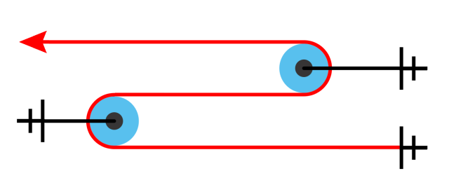

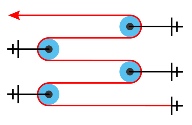

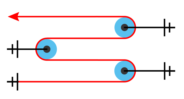

Chris McKeon wrote:I am wondering if instead of only running the cord through one Pulley that is attached to the Haul-Back. Maybe I will run the cord through double pulleys for the mechanical advantage. Or then again maybe I will regain My Strength,
You may find that you get diminishing returns from adding more pulleys. Let's assume that it takes 100 pounds of force to set the haulback in place. By adding one pulley, you can cut that down to 50 pounds of pull. That's a 50 pound difference!! By adding a second pulley, you can cut the pull down to 33 pounds. But that's only 17 pounds less than the 50 required for one pulley. By adding a third pulley, you can cut the pull down to 25 pounds. But that's only 8 pounds less than the 33 required for two pulleys. By adding a fourth pulley, you can cut the pull down to 20 pounds. But that extra pulley only saved you 5 pounds from the three pulley configuration. So the biggest "bang for the buck" is going from 100 down to 50 with the first pulley. Each additional pulley is contributing the same amount of cost and complexity but saving you less and less force for each one. The following diagrams show each of these examples.
One pulley cuts the load in half. So it would take 50 pounds of pull to move 100 pounds of load.
Two pulleys cut the load into a third. So it would take 33 pounds of pull to move 100 pounds of load.
Three pulleys cut the load into a fourth. So it would take 25 pounds of pull to move 100 pounds of load.
Four pulleys cut the load into a fifth. So it would take 20 pounds of pull to move 100 pounds of load.
Note that these examples show the keel anchors on the left and the haulback anchors on the right. In other words, all of the anchors shown on the left are connected to the keel. Similarly all of the anchors shown on the right are connected to the haulback line. Also note that multiple pulleys (on either side) could be physically grouped together in a single housing such as a typical "block and tackle" configuration. They're shown here as individual pulleys for clarity.
