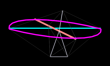

Postby Bob Kuczewski » Tue Oct 18, 2022 10:24 pm
JoeF wrote:Dihedral and sweep. ... Coding challenges ahead!
As a suggestion, you might want to start by building as close a model as you can get with the standard Glider Designer tool. It operates at a much higher level and you'll get a pretty nice wing. Then you can export the model in "raw" format (when I post that new version) which is the format you've been working in with the current tool (Frame Designer). That's where you can add things like the bow sprit and move the crossbar to the trailing edge. Here's a version that I just modified to be close to your design but with some dihedral and sweep. I also moved the center to the crossbar to the trailing edge in preparation for making your aft (trailing edge) spar:

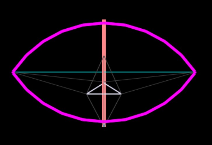

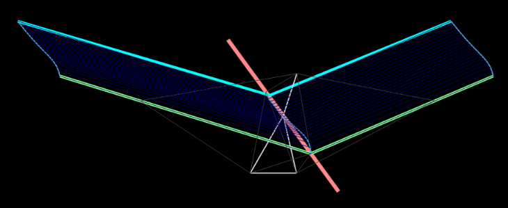

If you view that in Glider Designer (the older program) you'll see something that's pretty close except for the misplaced cross bar, lack of a bow sprit, and missing cable stays. I added all but the cable stays in Frame Designer (the newer program). as shown here:
Screenshot at 2022-10-18 22-57-41.png (80.63 KiB) Viewed 1762 times
Here's the Frame Designer version with the relocated crossbar (now aft spar) and the extended keel (bowsprit):

[-15,-4.598167884534929,1.5081349077179624, 0,1.4103069955506737,0.050215281242408046, 1, "000077"],
[0,1.4103069955506737,0.050215281242408046, 15,-4.598167884534929,1.5081349077179624, 1, "000077"],
[-15,-4.899525594007917,1.4783966276940141, 0,1.108966786672418,0.010486238089625005, 1, "000077"],
[0,1.108966786672418,0.010486238089625005, 15,-4.899525594007917,1.4783966276940141, 1, "000077"],
[-15,-5.2008636784148985,1.4517043930232216, 0,0.8076450310211305,-0.024798528205739037, 1, "000077"],
[0,0.8076450310211305,-0.024798528205739037, 15,-5.2008636784148985,1.4517043930232216, 1, "000077"],
[-15,-5.502184347468942,1.4280753976009573, 0,0.5063395292603907,-0.05559071111776101, 1, "000077"],
[0,0.5063395292603907,-0.05559071111776101, 15,-5.502184347468942,1.4280753976009573, 1, "000077"],
[-15,-5.793770209046768,1.4080944830309126, 0,0.20504843183984534,-0.08191107889128131, 1, "000077"],
[0,0.20504843183984534,-0.08191107889128131, 15,-5.793770209046768,1.4080944830309126, 1, "000077"],
[-15,-6.095061921223693,1.3903680171513166, 0,-0.09622982704016447,-0.10382465252920979, 1, "000077"],
[0,-0.09622982704016447,-0.10382465252920979, 15,-6.095061921223693,1.3903680171513166, 1, "000077"],
[-15,-6.396341136807699,1.3755293455963153, 0,-0.39749658177096947,-0.12142429877546287, 1, "000077"],
[0,-0.39749658177096947,-0.12142429877546287, 15,-6.396341136807699,1.3755293455963153, 1, "000077"],
[-15,-6.697609087348449,1.363486938668651, 0,-0.6987529768611527,-0.1348197787741793, 1, "000077"],
[0,-0.6987529768611527,-0.1348197787741793, 15,-6.697609087348449,1.363486938668651, 1, "000077"],
[-15,-6.998866842744699,1.3541444073033084, 0,-1,-0.144130390204596, 1, "000077"],
[0,-1,-0.144130390204596, 15,-6.998866842744699,1.3541444073033084, 1, "000077"],

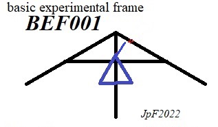

:) :) :) That brings us to the triangle that is in BEF001 where there is no load on a bow sprit because of the triangle on each side wing; with such, the bowsprit is disappeared. :)
That instantiation you just made is very pleasant to view in the viewer! Thanks.
But Bob, your note encouraged making BEF015 that distinguishes from BEF001 because BEF001 seems to tell of the loose TE sail. BEF015 distinctly has a firm spar at or near the TE; small extensions aft of the aft spar seem optional and sometimes very interesting. But the BEF015 triangle of spars-keel takes away bow sprit and the attending lines. In BEF015 instantiations there are many opportunities for experiments with sail appliques and stuffers in DS socking. One instantiation of 10 ft of sail at keel with two equal telescoping spars of 15 ft length for each side wing would give a sail area of about 141 sq. ft. Quick area calculator using three sides of triangle: HERE.

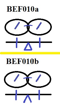

Postby JoeF » Wed Oct 19, 2022 9:05 am

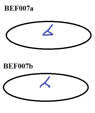

Series of bow frameworks is in the works for bow-related frameworks for HG design experimentation. Tense a spar into a bowed spar using a bowing line; such makes for a planar segment that is a circular segment. Depending on the actual materials used in the bowed spar, a non-circular bow may result; e.g. a tapered spar bows to non-circular form. There are distinct types, considering only some types at first.
:arrow: Type 1: Already in two BEFs posted: BEF007ab and BEF010ab These bow full hoops, the hoop closes in on itself.
:arrow: Type 2: One spanwise bow wing, yet to be given a BEF. Some developers have explored HGs of this sort. As yet, I am guessing "dirty" rigging has not been explored enough; those who have depended on cantilever efforts have their targets. But a "dirty rigging" exploration may allow some benefits for the low performance players. Non-Kp-Qp Longbow can be studied here. But there are many alternative instantiations of "Type 2" that may be studied.
:arrow: Type 3: LE spar of full span and TE spar of full span together bowed with a common bowing line. This is different from full ellipse, full oval, full circle. So, a BEF will be composed to express a family of HGs using two spanwise bowed spars. Canti-levered instantiations tend to be heavier than line rigged using Kp-Qp to reach for lower mass for more pleasant tote in tiny packs meeting the targets mentioned in the present topic.
:arrow: Type 4: Marrying two bows per side for a total of four bows in robust King-Queen rigging may not have been explored. An aim is to get sail area increase over that which is obtained in BEF015 instantiations; and perhaps some assets stemming from "captive arch" physics. Note: the two bows needed not be joined at both ends; that is, the bows may end at keel at distinct points, say 7 ft apart. A BEF for this is in the works.

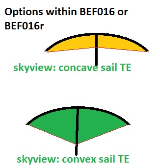

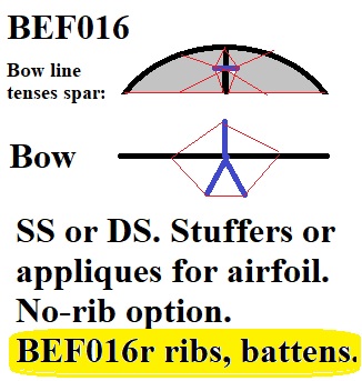

Postby JoeF » Wed Oct 19, 2022 3:47 pm
BEF016 and BEF016r
BEF016 and BEF016r
The indicated keel frame piece may be longer or shorter to cause the sail to be convex or concave at the TE at the keel.
The "r" experimental space regards having battens or ribs or shaped battens.
Else, without the "r" there are not rib or rib-like battens, but only stuffers and appliques to form airfoils and optional control actions.
Some options in the BEF016 experimental space are indicated.

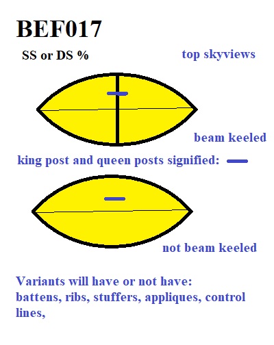

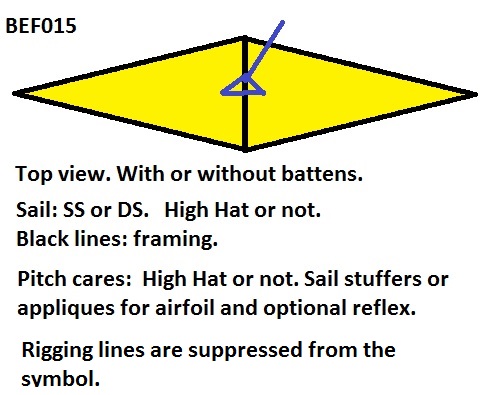

Postby JoeF » Wed Oct 19, 2022 7:58 pm
BEF017
Is this the "football" BEF (basic experimental frame)?
Circular segment calculator Remember to double the answers for area, as two approximately circular segments are in the hang glider. "Approximately" because the design of the spars to be bowed may well get the forms in box different from "circle" related.
Span and spar length here are not the same; the arc length involved form the spar lengths. The bow line would be the span of the wing.
Two socks could be involved for a DS deal. But some experiments will have DS for say 30% on average, or 40% on average beginning at the leading edge.
Experiments with full SS still may have appliques for airfoil formation including camber and reflex effects. Formed battens and flat battens are optional to form various experiments.
Use of drop lines from rigging lines may be explored for airfoil formation in SS or DS$ deals.
Notice how BEF017 differs from BEF015.

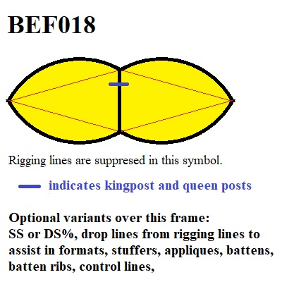

Postby JoeF » Wed Oct 19, 2022 9:52 pm
:shifty: BEF018
We continue to aim for tiny packing for tote as per topic of this discussion thread.
:arrow: Anyone in the world is free to spawn HG instantiations of BEF018; consider reporting experiences in the US Hawks forum.
In a few posts back in this topic JoeF wrote: :arrow: Type 4: Marrying two bows per side for a total of four bows in robust King-Queen rigging may not have been explored. An aim is to get sail area increase over that which is obtained in BEF015 instantiations; and perhaps some assets stemming from "captive arch" physics. Note: the two bows need not be joined at both ends; that is, the bows may end at keel at distinct points, say 7 ft apart. A BEF for this is in the works. [in quote "needed" was edited to "need" with approval of the author]

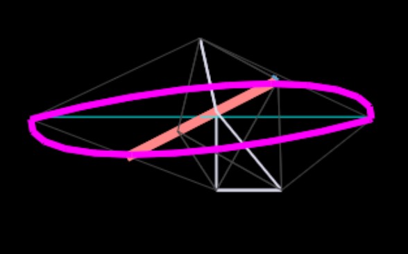

Postby Bob Kuczewski » Thu Oct 20, 2022 7:04 am
Here you go Joe:
View it in 3D with this code:
Code: Select all
  [0,5,0, 0,-4.8,0, 7, "ff8888"], // Keel
  [0,-0.0,0.1,   8.3,-0.0,0.1, 5, "00ffff"], // Right Crossbar

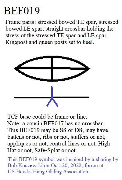

Postby JoeF » Thu Oct 20, 2022 1:09 pm
Fun!
Herein I tweaked one line of code to have no frame crossbar, but have a bow line that holds the stress of the two perimeter bowing spars. I just lowered the thickness number and renamed the line. I saved the coded line, but suppressed the crossbar line with "//" use. BEF017 was first intended for no-crossbar frame while emphasizing that the perimeter of the macro frame is a set of of two stressed bowed spars. The bowed spars would be Kp-Qp stayed with upper and lower stay lines.
Keel framed. No beam frame for crossbar, just bow line. BEF017 lives in shown. The green line is a tensed line that holds the stressed TE and LE spars.
So, Bob, maybe a new BEF symbol could be for a HG family that had bowed spar LE, bowed spar TE, and straight mid-spar (cross bar); let that be BEF019:
:arrow: :salute:
Code: Select all
