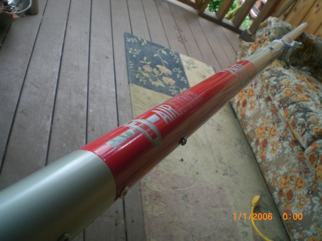

I left this morning after posting my idea and went out back and built it. it was very easy to build...I also took video and gave a short presentation on how it might work but I have wasted all morning trying to upload my video to youtube...I am basically a handicapped person when it comes to most things internet. I will see here if I can upload a picture of the keel with the bicycle tire pump spliced into it.

Postby reluctantsparrow » Mon Apr 25, 2016 5:48 pm
All re-assembled and ready to crash test....need a rope for a zip line though
