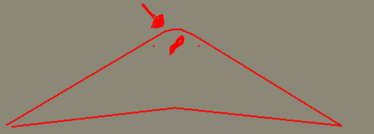

Wait! Don't dive into anything too soon. Proof of concept time on one tangent could lead one away from an even better solution. One that hasn't exhausted the brainstorming of the R&D committee. List some more ideas then pick one or morph to a combination of the best two.
Here is another suggestion to pick from or expand on.
We should be able to fly a plan-form that doesn't come to such a sharp point at the nose of the glider.
What if the nose was a shallow arc to allow more room between the nose flying wires?
Blunt nose, wide flying wire attachment points, Fared caster wheel..PNG (22.08 KiB) Viewed 4508 times
Make enough room between the attachment bolts on the underside nose (wide) plate for a fared caster wheel to swivel and clear the nose flying wires. If the nose-in was not straight on but to the side after hooking a wing tip on the ground the nose caster wheel would help prevent the abrupt stop of the gliders nose when it hit the ground. :?: :?: :idea: :?:
