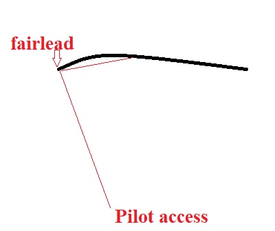

Postby ARP » Wed Nov 16, 2022 5:47 pm
JoeF wrote:Wing stuffers' positions may be set by a string to the leading edge (LE) in some HGs. Also, consider having the position-keeping string be continued to the (TE) trailing edge or nearly so. Between flights a stuffer could be pulled forward or rearward. Results are invited to be described by anyone. Wing stuffers may be designed to fit special purposes.
Variable camber ...
For a single surface wing a simple bow line from leading edge of the aerofoil batten to a point approx a third along its length could be used and tensioned to form the aerofoil arc. Line length and attachment point are variable to change to the desired profile.

One of the issues of making a glider easier to fold is the pre-set battens have to be removed from the sail to allow folding with a c.f. flexible batten they could be left in the sail and the bow line then tensioned to form the aerofoil radius.

Postby JoeF » Sat Nov 19, 2022 7:48 pm
ARP wrote:For a single surface wing a simple bow line from leading edge of the aerofoil batten to a point approx a third along its length could be used and tensioned to form the aerofoil arc. Line length and attachment point are variable to change to the desired profile.
A particular stationed aerofoil batten using such arrangement could have its bowing line be a source of active in-flight control.
Or in experiments, the bowing line could be changed between flights for experimental tuning of the aerodynamics of a particular HG.

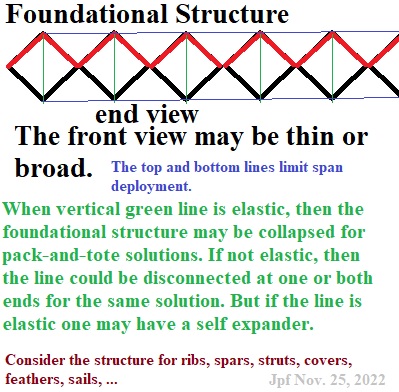

Postby JoeF » Fri Nov 25, 2022 1:43 pm
A foundational structure that may be used in some hang glider builds to assist in tiny packs for pleasant totes:
The pleats may be tapered. Final sets of lines at top and bottom may be anchored to the peaks so that the structure remains straight at deployment or may end up curved. When used as a rib with pleats set normal to wing chord, then the pleats may be seen as compression members maintaining designed airfoil; cavities of the double pleat structure may be kept empty or be with an insert, say, for added resistance to compression for flight loading.
The double accordion stayed-elasticized structure might use papers, films, plates, struts for the zig-zag elements. The lines that limit length of the deployed cells could be textiles or films, depending on uses desired; anchoring lines to the pleated rigs could be permanent or temporary. Appraise material efficiency with other construction options. Failure modes of the optional structure will depend on uses, forces, fatigue, ...
Note on the drawing: All the red could be a pleated sheet, for example; all the black could be a pleated sheet; then the joins of the red to black could be via a flexible hinging.
Note: if the red and blacks are struts then one could consider de-coloring and have through structs pinned at rotating joint for obtaining an alternative result.
Without the stays and the elastic strategies mentioned above, here below is a cousin exploration of bidirectionally flat-foldable cellular origami structure:
Postby KaiMartin » Mon Nov 28, 2022 7:07 pm
This looks like a great way to achieve an airfoil with cost effective run of the mill straight carbon tubes. Unfortunately, the curvature does not quite result in a NACA airfoil. The section covered by the string will bend the most in the middle between the two attachments of the string. So the leading edge portion of the batten is bent only slightly. By contrast, the curvature of virtually every desirable airfoil bends the more the closer to the leading edge. There is a solid aerodynamic reason for this geometry: The curvature accelerates the airflow. Too much acceleration results in flow separation, i.e. a stall. The larger an angle of attack can be without stalling, the better.
To avoid flow separation you'd want the air to accelerate early and also smoothly. This results in airfoils with increasing curvature toward the leading edge. Put differently, an airfoil that deviates from this very general design principle will probably expose the pilot to some nasty stall behavior.
The curvature may be more like a desirable airfoil if the diameter of the straight tube diminishes toward the leading edge. This seems like a special and therefore expensive requirement. But maybe, there is a readily available mass produced product that fits the bill: Carbon fishing rods. These rods are thin and bendy at the tip ;)
JoeF wrote: A particular stationed aerofoil batten using such arrangement could have its bowing line be a source of active in-flight control.
As drawn, reasonably stiff battens would exert a substantial pull on the pilot. This may be mitigated by pulleys and/or levers. I'd expect the associated complexity and weight penalty to be prohibitive.
JoeF wrote: Or in experiments, the bowing line could be changed between flights for experimental tuning of the aerodynamics of a particular HG.
This seems like a more realistic mode of operation for the strings.

Postby JoeF » Mon Nov 28, 2022 9:28 pm
Kai Martin wrote: But maybe, there is a readily available mass produced product that fits the bill: Carbon fishing rods. These rods are thin and bendy at the tip ;)
Thanks, Kai.
Explore multiple strings on same batten. Say, two strings; one for the tighter accelerations. The other for the slower accelerations.
