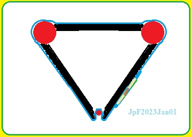

Evolution of one type of spar of coilable parts:
Parts:
= compression coilable flat
= spreader coilable flats (two)
= case for spreader assembly; the spreader case is bonded to the two flats in the region where the tension cable will seat; a sewn X hinge will be bonded at the tension-cable seat.
= hook-and-loop
= straps or an overall sock case
= spar-end bridling cap (two) that is perma-fixed to a tension cable or tension webbing.
Assembly of spar at flying site:
Uncoil spreader assembly.
Uncoil compression flat.
Lay out tension element with its two bridling spar-end caps.
Set compression assembly onto the spreader assembly.
Set spar-end caps onto the ends of the compression flat.
Check that the tension element seats into spreader-assembly lower joint.
Apply hoop straps every 1 foot along the span of the spar. Or alternatively, slip a sock case over each half of the tapered spar to play a part in snugging compression flat to the spreader assembly; aim to avoid a zippered overall case.
Packing a spar for tote: (Intended: two spanwise spars in one make of HG; or four half-span spars in a KP-QP rigged HG)
Take off the overall socks. Fold the socks to a tight pack.
Take off the tension cable or webbing and remove the caps from the end of compression flat.
Unhook the compression flat from the spreader assembly. Coil the flat and safety strap the coil.
Let the spreader assembly close its V to be an I; coil the spreader assembly and safety strap the coil.
Spar coils may stack or nest or both. Coil cavities may hold other HG parts.
Postby JoeF » Wed Jan 04, 2023 6:21 pm
An alternative of the above suggestions is to have the spreader assembly as told: coilable, but have the compression element be segmented to 1-m segments while tapering as needed. The lower part of the spreader flats will be in tension during positive-flight loading. The compression element segments could be snugged to the lower spreader subassembly via hook-and-loop and the tapered over-all socking or strapping.
Segmented compression element for a spar positioned-stabilized by marriage to the spreader subassembly and by assist from KP-Qp rigging and rib connections to a second spar would be helped by some interlocking shaping of segments. The shaping could be gentle V. Or two pins into holes of adjacent segment.
Postby JoeF » Thu Jan 05, 2023 12:03 pm
Setting:
Mono-spar monoplane SS or DS, no sweep:
Consider, for a triangular cross section spar having an upper compression-element-segment set over a spreader-V flat subassembly, the opportunity of grooving the underside of the compression elements; the spreader flats would seat into the spanwise grooves and finally be pressed as a resultant of flight loads via the action of the spanwise tension cable/webbing and perhaps spar socking. Such would firm the position of the spreader flats and avoid a use of hook-and-loop runs. Keep the spreader flats coilable for half-span. Rig: KP-QP.
And consider now three-part ribs with center part hard set to the compression element segments of the spars; this would give an opportunity to control wing torque when two-point bridling the center rib part on some ribs, not all. Drag of rigging: accepted. A stay-put line might root at wing tip compression-element tip; the line would stay the position of the ribs that are set to the upper part of the compression elements countering the in-pull of ribs that the KP-QP rigging would bring. Similarly rooted stay-put lines (two) could keep the ribs aligned on designed angle to the spar. Such lines might be used to tune the wing.
Postby JoeF » Fri Jan 06, 2023 11:32 am
Awaking this morning: "Let the tension element drape the apex of the spreader subassembly! Figure ways to stay the tension element's position while letting the two spreader flats firmly meet with a flexible hinge; have the tension member drape and snug that hinge line. Thus keep the V's apex from moving. The draped tension element might be a two-lobed item to help assure stay-put seating during flight loads. Challenge: prevent the tension member two parts from dimpling the spreader flats' faces: how? Maybe an insert inside the V could be placed and removed? Bjut compression would tend to squeeze the insert and cause the insert to rise up out of place. Not sure here. Worth exploring .... [ ] "
