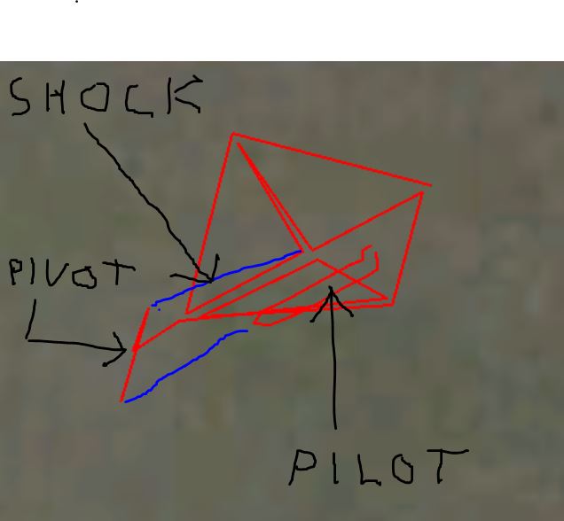

RS,
My best guess is that the angle arm coming down below the keel tube will put too much of an out of column load on the keel which will bend or kink the keel tube as it restricts the forward movement of the pilot.
I'd guess that a compression shock with a bridle line running from the keel at an angle to the pilot would withstand much more of a load before damaging the keel.
All though it gets too complicated I would think a hinging "T" tube perpendicular to the keel would tend to keep the compression load more in line with the keel.
Think of the T as having a pivot point where the vertical leg meets the horizontal part of the T.
With the --- This explanation is not working --- I can smell your gears grinding from here.
Let me try to attach a picture ---
T pivot. bridle, shock absorber.JPG (31.6 KiB) Viewed 4114 times

Bill Cummings wrote:RS,
Wont know until it is actually tried of course, but you raise a valid area of concern and a potential remedy to address that concern.
However, if the device becomes too complicated....hmmmm.
we need an idea that does not increase drag in regular flight,
We need the device to be an after market bolt on to encourage widespread usage of the device.
We need the device to require no alteration of key structural components of the aircraft.
the rear flying wire/rear landing wire junction is extremely strong and provides a huge amount of columnar support.
the device should attach as close to that junction as possible, to the rear of that junction if it is to remain an aftermarket device.
your drawing fulfills all those parameters except the hinging point on your drawing is farther away from the rear landing wire/rear flying wire junction than I envision and an external shock assembly running to the heartbolt area provides a great deal of drag and complication but your idea has given me another idea.
the downward swing of the stinger could take place with zero or a very small resistance factor beginning when the pilot has pulled in the basetube past the upper abdomen area. the stinger continues to deploy as the pilot continues to pull in (providing no resistance to the pull in) until the basetube is fully stuffed.
so when the glider is fully stuffed there will be a stinger hanging down waiting and ready to provide shock absorption in the event the pilots body swings forward beyond the fully stuffed position but not until then.
this accomplishes two things:
1. the keel is under no pressure as the stinger is lowered into position.
2. At high speed (fully stuffed) the fully deployed, downward angled stinger provides drag and a stabilizing factor in a high speed dive, reducing PIO potential.
Last edited by reluctantsparrow on Sun May 22, 2016 9:33 am, edited 1 time in total.

Postby Bill Cummings » Sun May 22, 2016 9:40 am
reluctantsparrow wrote:A stinger that pre-deploys in this manner also accomplishes a third major safety factor.
3. the arm is fully deployed and ready to engage from a position that places the bridle or leash in-line with the keel of the glider before rapid deceleration of the glider takes place, greatly reducing, if not eliminating completely, the pendulam action that swings a pilot up into the keel of the glider.
Plan B with limitations:
Assuming that pilots that buy topless gliders won't even let a shoulder to shoulder strap pro-tow bridle flap in the wind after releasing from tow;
I see an after market safe splat add on as a much harder sell to pilots in the competition mind set.
If we scrap an idea because it is not universally embraced it will not protect that part of the flying community that flies with king posted gliders.
Plan B is for the segment of the HG pilots flying king posted gliders.
Plan B:
1. How about a 3/16" hinge pin located one and one half times the diameter of the keel tube rearward of the rear cables anchor point.
2. Two Aluminum straps, one on each side of the keel-tube.
3. The two Aluminum straps would normally lay along each side of the keel when not deployed.
4. When the pilot swings so far through the control frame the two Aluminum straps will hinge perpendicular to the keel-tube.
5. What keeps the Aluminum straps from rotating beyond the desired limit will be another 3/16" pin, rising up, coming in contact with the rear king-post wire.
Re: Safe-Splat
Postby reluctantsparrow » Sun May 22, 2016 10:15 am
That is absolutly brilliant Bill! You just opened up LOTs of possibilities !!!!! Your idea as is can be used to predetermine the foreward motion of the pilot.....the resistance is only aplied after the arms swing down into position therefore reducing the upward swing of the pilots body....the upper pin resting against the rear landing wire could be a small bow roller that snuggles the keel when it is not engaged but also provides a nicely curved place for the rear landing wire to snuggle up against as well. the kingpost can now be fitted with a compression device to dial in the amount of resistance and travel allowed.....your idea is an aftermarket bolt on.....plus an after-market shock absorbing kingpost or shock-absorbing device built into the rear landing wire itself....or....it could be built into the front landing wire and the weight of the shock absorbing device would counterbalance the weight of the pivoting device.....the front to rear landing wire would probably need to be beefed up .....a few other details to work out.....but
.... your dual, pivoting arms could be made streamlined to flush up nicely along the keel in regular flight!...the only extra drag would be the leash and a small amount of parasitic drag from the devices.......
And your idea is super simple....Any backyard mechanic could build this in their own garage!!!!! I could mock up a prototype this afternoon this idea is so simple.
I dont like this idea Bill....I LOVE it!!!!
