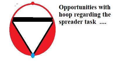

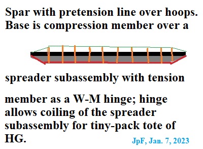

A solution might come from the following: Recall the X hinge at the apex bottom of the V spreader subassembly. Consider letting the X hinge become a W-M hinge: by that I mean: sew two lines of straight seam on two layers of material:
The left flaps are bonded to the bottom of one spreader flat; the other right flaps of the W-M hinge are bonded to the bottom of the other spreader flat.
If the W-M hinge is flexible material, then a hinge results allowing coiling the spreader subassembly of a spar or beam. The cavity may allow the insertion of a Dyneema cord for tension member of the spar. But, moreso, the hinge material may be chosen so that the hinge material becomes the tension member of the spar. This all might remove the challenge mentioned in the above prior post of yesterday.
Furthering: KP-QP rigging of the HG may pretense the spar recently being developed. However, some integrated pretension is probably going to be a good thing to address handling, negative flight loads, and firming the shape of the beam or spar prior to finishing full KP-QP rigging. So, a pre-tensioning tension line may be a kind of continuation of the main lower spar tension line.
The compression member of the spar may be segmented for tiny packing.
An avenue to explore: how might the hoops play a part in the spreader subassembly while giving some body to airfoil formation while still giving pretension to the segmented compression subassembly? It looks like there is some opportunity herein.

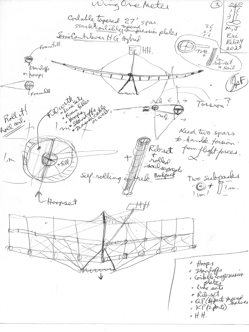

Postby JoeF » Fri Feb 24, 2023 9:04 am
An optional direction for the theme of "one-meter" deals:
Attached is this morning's offer of a HG that would be toted in two subpacks, one perhaps on back and one in hand. Or both in hand. But one subpack could roll by pulling or towing. Hoops, coilable compression plates (two or three per full-span spar), stand-offs, tension members, line sets, queen posts, kingpost, keel parts, high hat subassembly, rib sets, sail segments, control line between the two queen posts, compressible foam fill, sail segments.

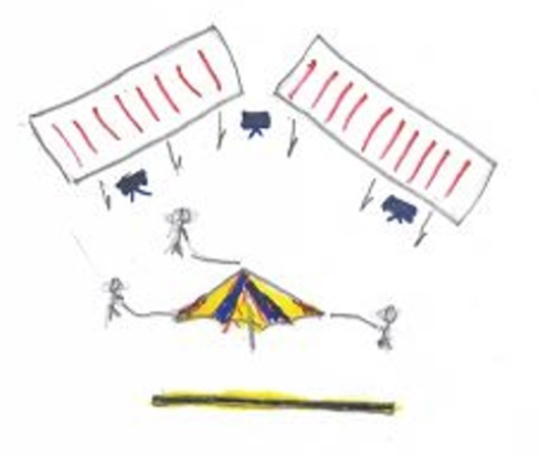

Postby Craig Muhonen » Tue Feb 28, 2023 2:43 am
:salute:
I had this idea Joe, to go along with the 5' packed movement, which has gained 135,000 views in 7 years on US Hawks :thumbup: :thumbup: :thumbup: :salute:
It's a portable, wind powered training device and "video machine",
wind machine and HG sim.png (143.78 KiB) Viewed 2026 times
where the 5' packed movement, and HG clubs in general, could also become an ongoing video platform (the LLC or a blog) on to itself.
There is so much data scattered around.
Sky divers have a vertical wind machine, Hang Gliders need a horizontal one.
This video machine could also be set up on windy days, without the need for blowers, and as a side light,
interview people who are interested in the whole PG, HG thing, and which wing to choose to put your life under.
There was a time when John Heiney wanted to build a HG wind simulator with video.
He did do "Off and ON", which is one of the best HG training videos, and his music choices are masterful.
He said that if he built one, "they would come", but no time or money.
people will ask, "what is this hang glider for"?
you can say, "come on, strap in and we'll make a cool video together, and who knows.
