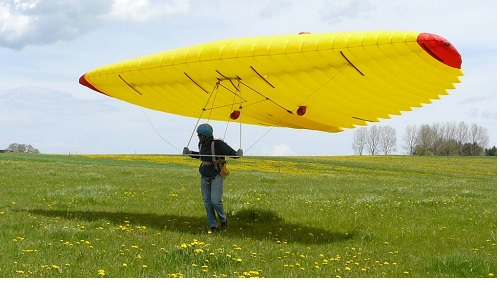

Postby JoeF » Sun Mar 19, 2023 11:57 am
Close to theme is mentioned:
https://en.wikipedia.org/wiki/Kalbermatten_Woopy
Verification is needed on the specifications:
Quote: "Woopy Jump
More portable development model. Its wing is also inflatable and the glider empty weight is 7 kg (15 lb) and the aircraft can be folded into a bag 160 cm (63 in) long.[1]"
Distinguish between Woopy Fly and the Woopy Jump.
Not sure of specifications of shown wing:
Caption quote: "The wing Is called Woopy jump and it's an inflatable rigid construction wing,wingspan of 5,20m and 10sqm of surface area " Need verification of dimensions... [Unverified: about 108 sq. ft.; about 17 ft. span]
Not sure of dimensions:
Exploring:
http://www.laboratoridenvol.com/project ... ex.en.html
Not sure of dimensions of the wing when motorized:
Something else: "Wingjump"
Some WayBack Machine re: woopyjump.com
https://web.archive.org/web/20090226040 ... yjump.com/
HISTORICAL
Since 1995, Laurent de Kalbermatten has been experimenting with inflation systems for all types of wings in order to obtain the lightest and least bulky flying machine possible.
With the Woopy-Fly concept and its blower inflation system, we are really getting closer to the desired goal. Hundreds of flights performed, both in free flight and in powered versions, as well as load and high-speed tests and intense computer simulation sessions enabled Laurent de Kalbermatten to validate the concept.
At the same time, with the invaluable support of its test pilot Guy-Bertrand Jaquier, new ideas and applications have been developed for “terrestrial” sports. The goal: to use this inflated wing concept to extend ski and snowboard jumps.
The WOOPY JUMP was born…
Feeling the lunar gravity in complete safety, moving between heaven and earth, these are two objectives of this new sport!
A mix between the pleasure of free flight and the mountains, an extraordinary sport, unparalleled sensations!
HOW TO PRACTICE
The principle of Woopy Jump is simple. It is a wing made of high quality nylon fabric and whose self-stable aerodynamic profile is shaped by inflation.
Two small electric fans of 6W each, powered by batteries, ensure this mission. Thus the Woopy Jump, unlike the paraglider, is fully inflated before take-off.
Just face the slope and ski. The Woopy Jump raises itself above the pilot. The latter only has to feel the lift and “jump” as he pleases. Once in flight, the air pressure is added to that of the fans, which then only have an auxiliary role.
The pilot is suspended by a harness from an aluminum and fiberglass spar which crosses the wing from side to side. Two handles integral with this spar are used to maneuver the device.
Piloting is done like a hang-glider with the possibility of acting on roll and pitch in order to extend and direct jumps. long jumps.
The Woopy Jump is implemented quickly (less than 10 minutes), is easily transported on all ski lifts, as well as it finds its place in the car like a pair of skis.
Folded in its cover, it measures 1m20 for a diameter of 25cm and is carried like a backpack. Ready to fly, it has a wingspan of 5.20m for a surface area of ​​10m2 and weighs around 10 kilos.

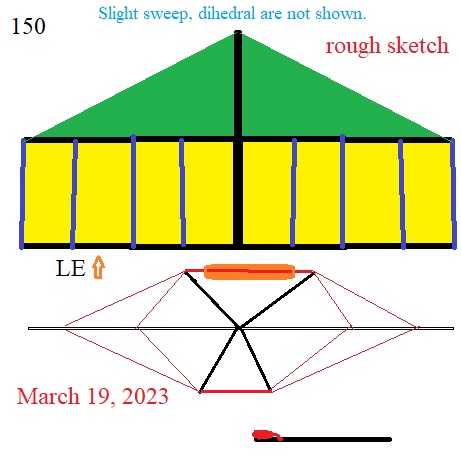

Postby JoeF » Sun Mar 19, 2023 2:17 pm
For lack of a permanent name yet, the following addresses the "150 HG" of 5-ft packing for polite busable use. The wing will be a hybrid SS, 20-ft span, tip chord of 5 ft, root chord of 10 ft,, two parallel spanwise spars, two KPs, two QPs; the "basebar" of TCF will be line, not bar. Some sweep and some dihedral will be set. Operations: very conservative gliding.
The wing will be "line draggy" tolerated to achieve low mass in beams. Assembly will be quick: Unfold flat, insert one end of the non-completely-separated ribs, insert the separated ribs, insert the KPs, rotate wing for insertion of the two QPs, attach the aft special sail area's stay lines, attach fore and aft stay lines for KPs and QPs. Attach High Hat. Done. Check again all points. Jump test. Tighten rigging lines as needed.
Almost totally foldable" leaves some things to do before the folding.
Upon assembly unfolding will not be quite enough; there will be some things to insert or join to get the wing ready for flight.
The first main tiny pack will hold most of the "150": spreader beams, KPs (2), QPs(2), spars (two macro parallel in 5-ft segments), sail, rigging line. Most rigging lines will be firmly connected; only a few lines will have one end disconnected.
Some couplers will be in a second tiny pack along with the High Hat wing and LE applique compressed foam segments that firms shape of an airfoil.
Underway is a relatively fast-flying HG that will be very-much foldable; some of the spreader beams will fold into the pack while staying connected at one of their two ends, but some of the spreader beams will be fully removed to become separate parts to be rolled up with the main folded deal. The sail will remain fully attached to spars.

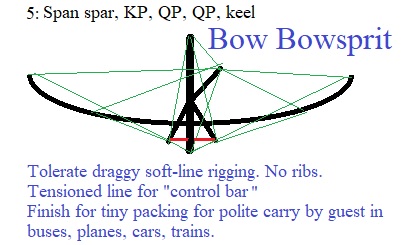

Awaking today, the following took high ground: A 5-beam Bow Bowsprit HG ... how to finish its aerodynamics without ribs and how to tiny pack it???
1. KP (option: split to two beams for V)
2. QP (queenpost)
3. QP (another queenpost)
4. Bowing span spar
5. Keel (... reaching to bowsprit)
Bow Bowsprit _________________The sail is not indicated.
Finishing options:
High Hat
Couplers
SS or DS sail
LE stuffers
Ribbing, but first exploration: no ribs
