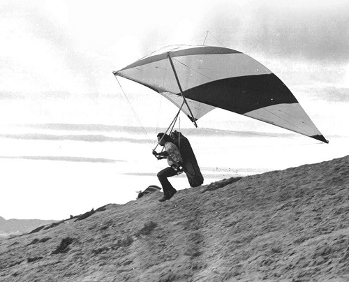

Eddie Paul Whitney (RIP) actually flew his hang glider while having a second copy of his HG Porta-Wing strapped to his back. His HG had a cable-LE challenge that was not copied by others for substantial reasons. But his demonstration of small packing was acute in the early 1970s. Earlier in this topic thread, hang gliding's first official org formally titled historian Neil Larson mentioned Eddie Paul on this point. Eddie flew his Porta-Wing in some severe conditions and had an injurious crash resulting in some serious surgery. But his death was from non-flight causes.
Some discussion on Eddie's matters in our forum: Keywords: cable leading edge sails, Porta-Wing, portawing, E.P. Industries, Eddie Paul, "cable leading edge"

To accommodate the flood of movie and television work that followed, Paul quickly moved to a large Franklin Street warehouse. For recreation, he took up hang gliding at the Dockweiler Beach training center, which led to his design and manufacturing of a hang glider he called Porta-Wing. It could be assembled in five minutes without tools and broken down into five-foot-long pieces, rather than the 25-foot-long pieces common at the time.
:!: :!: :!: :arrow: :arrow: Note: Before building and flying any cable-leading edge hang glider, I recommend that one study all sailboat sailing cable-leading-edge sail matters, all aerodynamic studies of cable-leading-edge wings, all critiques in hang gliding about the Porta-Wing. The matter is to be treated with highest technical respects. Concerns about trippy pitch matters, beam-buckling matters, and gust effects are some of the keen topics to be mastered. Modified or enhanced cable-leading-edge HG wings form a branch of experimenting that has yet to reach maturity: go forward with utmost care. :shock:

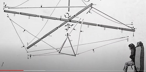

:wave: Note about Porta-Wing spar couplers: see interior insert that ate part of the pack length. Different could be the coupler proposed in a former thread post: exterior center-stop-butt over-segment coupler as separate part to avoid pack lengthening.
:salute: Notice how the Porta-Wing frame topology could be a base mimicking the Dial-Soap ship bowsprit topoloy whereas the Dial-Soap wing used the spar as the LE, whereas Porta-Wing started sail at the forward cable. The bowsprit Dial-Soap wing used the spar as sail LE base. In contemporary experiment at my shop: "build airfoil upon a taut-sail base" using spar LE in bowsprit spar topology. Special attention for anti buckling is recommended for the span spar of the bowsprit, sweep or not, keel-connected or not.

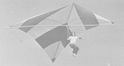

One source gives the following unverified notes on the Whitney Porta-Wing:
The Whitney Porta-Wing spars are in 4 ft lengths with aluminium sleeves which allows it to be disassembled in 10 minutes to a 5 ft package. A cable leading edge forms a cylindrical edge shape to give a gull dihedral for more lift.
The airframe consists of a keel and a wing spar that are kept under compression by a cable around the perimeter. Tubing is 2in x .058 6061-T6 anodised aluminium, reinforced with internal bushings. Sleeves are quad-spaced pop riveted into the main tubes.
All rigging is 3/32 in 7 x 7 aircraft quality. At the cable leading edge the wire rope is sleeved with “Eastman” plastic tubing. Double swagged throughout. All fasteners are grade 8 and thimbles are stainless steel, except heavy galvanised at the wing tips. Tangs are machined from stainless steel. Turnbuckles are polished bronze. All nuts and pins are aircraft quality. The sail is double zig-zag stitched from 3.8oz Bainbridge stabilised dacron. Critical areas are reinforced.
A swing seat was provided with 3/32in wire rope. The harness included sheathed tubing over the cables. Armaflex sleeves were on the control bars.
A low aspect ratio glider, it folds down into a small package 5ft x 1ft.
Leading edge: 18 ft
Keel length: 16 ft
Wing span: 26 ft
Wing area: 208 sq,ft
Aspect ratio: 1.6
Nose angle: 135˚
Sail billow: varies˚
Weight: 35 lb
Pilot weight: 140-220 lb
Takeoff speed: 5-7 mph
Stall speed: 4-5 mph
Max speed: 20 mph
Best glide ratio (L/D): 4-1
Best L/D speed: 15 mph
See spreader beam; look at left mid-beam and right mid-beam; do you see out-of-column formation?
Postby Bob Kuczewski » Sat Mar 25, 2023 5:10 pm
Joe wrote:See spreader beam; look at left mid-beam and right mid-beam; do you see out-of-column formation?
Yes.
I think that connecting any spar (under compression) at points other than its two end points risks such an out-of-column condition. In modern gliders, there are typically 5 tubes under compression (2 cross bars, 2 downtubes, 1 kingpost). Each is only connected to anything else at its two end points (except downtubes which are often strengthened against pilot's control forces). That's one of the advantages of the split cross bar - each half is only connected at its end points.
As soon as you connect a spar under compression to a third location, you must ensure that all 3 (or more) connection points will remain colinear. That's very difficult to guarantee in a structure as flexible as a typical hang glider.
