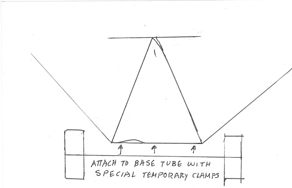

I seem to be trying to be the wheel landing champion at Dockweiler through no deliberate effort on my part. All have been smooth and without incident due to the big wheels. Those wheels are already on the two Windsports Condors and I have a set on my Alpha. I've utilized both. :o
I'm sold on those wheels for Dockweiler so I've been thinking of how we could have a "universal" set of big wheels available that could quickly be attached to any guest glider. Since most control base tubes would not be ready to slip the wheels on so it would have to be an outboard set with an axle tube clamped on the guest glider base tube. The biggest problem, as i see it, is that the wheels would have to be fairly far outboard of the base of the control triangle in order to clear the side wires. I'm concerned about how those wheels would affect handling in the air.
For most LZ's, as opposed to the beach LZ, the ground is hard so the wheels could be narrower and would be less of a problem. For gliders visiting Docweiler their inland LZ narrow wheels are not adequate for soft sand. They could assemble the control bar without them and then attach this temp guest wheel assembly for their flights there,
Drawing gives the basic idea so others can comment and suggest ideas.
