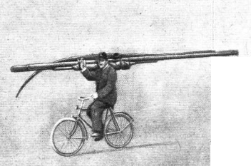

And I really like the old picture of him on his bicycle with the glider folded and on one shoulder.

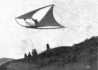

I'm curious about those lines that can be seen coming off the keel and wing tip. What are those doing? Someone appears to be holding one from the keel and another one being held from the nose. The ends of the rear lines don't show. It definitely looks to me like he is kiting and not free flying. With so many lines connected, stability should not be a problem.
From Bluff Utah, Frank C
Re: Should we try a different way? Designwise....
Postby Bob Kuczewski » Sun Sep 20, 2015 10:30 am
I'm wondering if it may have needed those lines for roll stability. It looks like all control is done by directly moving the forward keel. I can imagine that would be relatively easy for pitch, but very difficult for roll.
Sam, you're right. There's something about riding a bicycle with a wing on your shoulder that's very appealing!!

There is no film of a manned flight of this glider ( at least I have not found it if there is) but there is film of its assembly and unmanned launch off of the sand dunes. The lines were probably used to kite up the glider, initially, and then to tow into the lift band. After a few ridge soaring flights no further development was made. The jib sails were worked either together for pitch and differentially for roll. The pivot point of the jibs was moved back to about 1/3rd chord to balance and reduced the control effort.
On the HG I developed, using a similar plan form, the jib was fixed before flight and only weight shift was used. This worked ok but it was so stable that it took a bit of effort to get it to respond to control inputs.
The strength of the Platz glider wing spar, which was unbraced, was questioned in British gliding circles. However , as it never went into production that question was never answered. I have looked for more information on this glider but there is little to be found. No doubt Platz was too busy working for Fokker to spend any more time on it.
With a carbon fibre spar and keel the weight could be reduced and strength increased to make this a viable build for a modern version.
