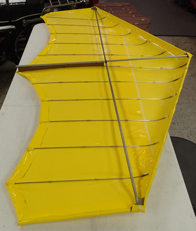

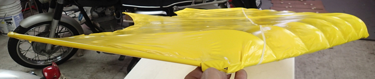

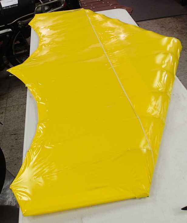

I finally got the model covered. I used an iron-on covering by Coverite called "21st Century Fabric". It's a prepainted thin woven cloth with a heat activated adhesive on the back. I also coated the battens with contact adhesive to help adhesion to the aluminum battens when the covering is applied with their temp controlled trim iron.
Unfortunately, this is not going to be a good test of this flex wing design because in order to get the covering smooth I had to heat shrink it. Therefore the sail is too tight and it will perform more like a rigid wing. A king post with deflexors would not help much with creating additional reflex at low angles of attack. This is disappointing and in flight tests I may have to bend some more reflex into the rear of some battens to get enough pitch stability. Time will tell. A full scale version would not have enough weight shift roll control with this tight of a sail. However, I should be able to trim turns into or out of the model by sliding the cross spar in relation to the keel. It's held to the keel tightly by two zip ties so it will stay where put.
Check out the photos.

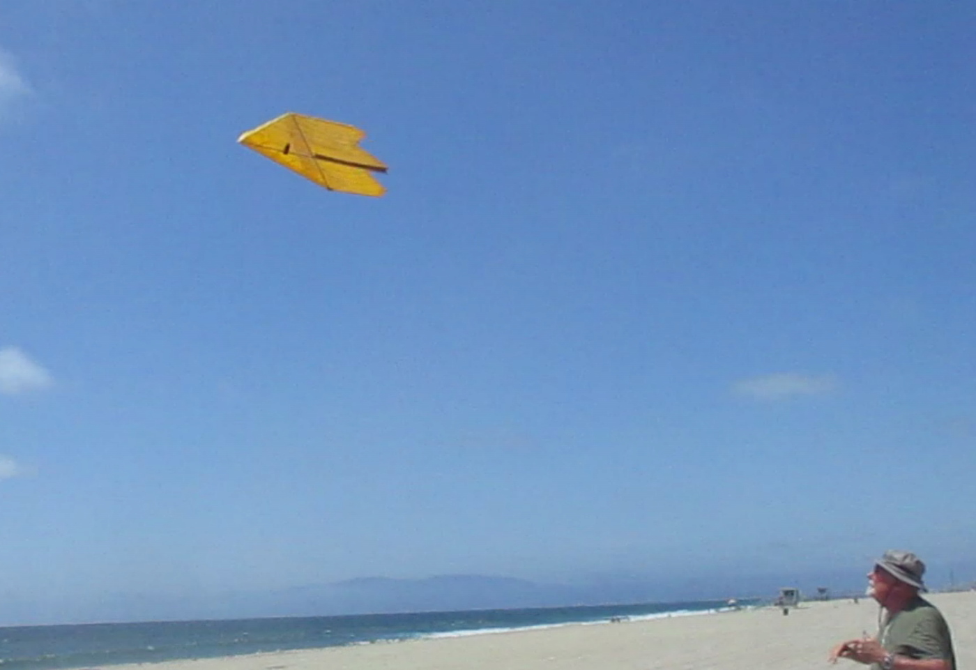

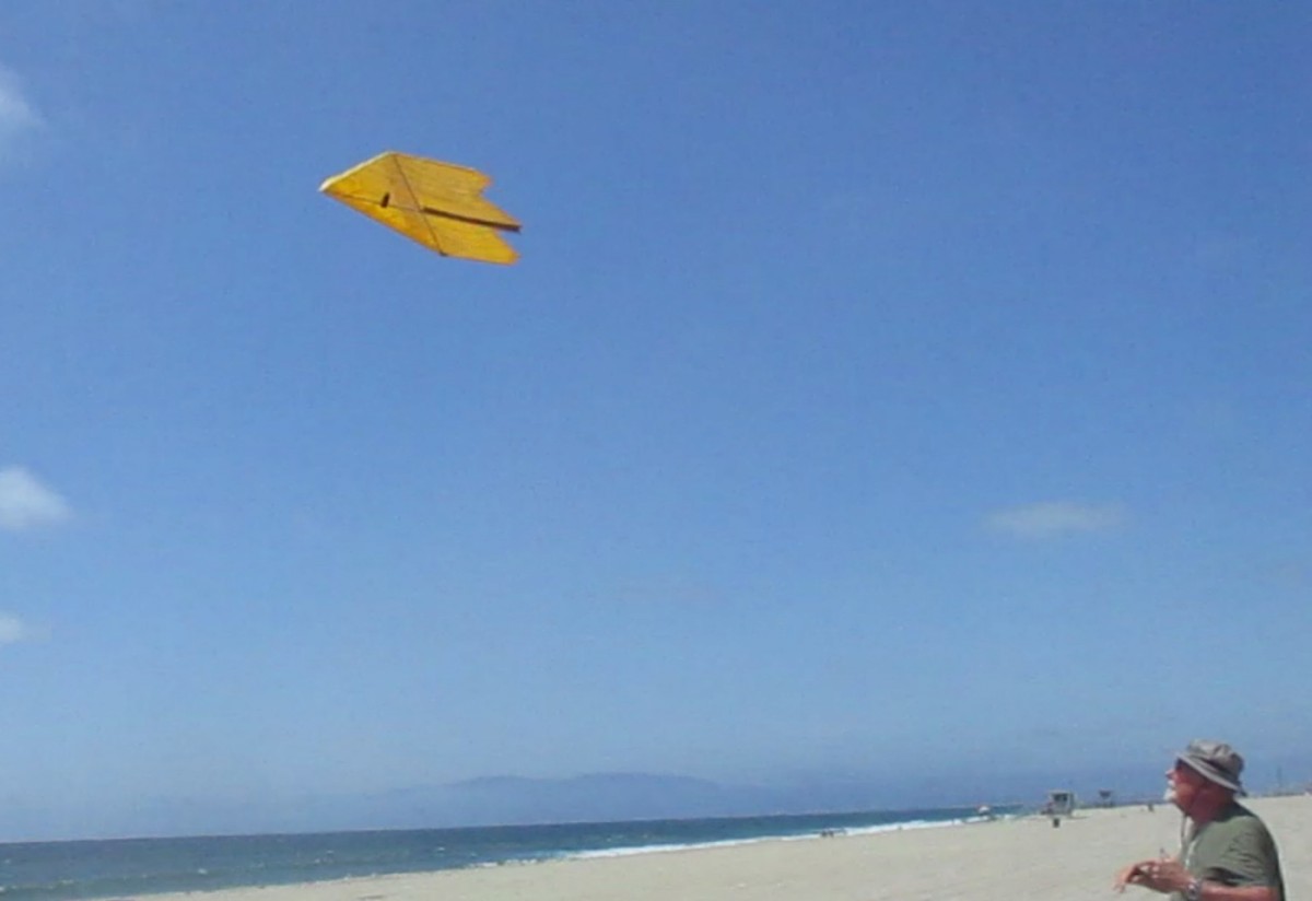

On Tuesday (8/14) I test glided the 1/5 scale model on the beach at Dockweiler. As most first time tests of a new design it had some good messages for me and some lessons.
I'll start with the lessons:
I covered the model with a coated cloth model airplane covering material that had a heat activated adhesive on the back. Using that, plus some contact cement painted on the battens, I felt that I had pretty good adhesion between the aluminum battens and the covering. So, I decided to skip the next step I had planned. That was to tape the battens to the covering after I could turn the model upside down.
The first test glide, with a dive to the sand, showed that i didn't have enough reflex & CG (adjustable) too far forward. I expecteds this and had planned to bend reflex into the back part of the battens which I did. The covering it tight so deflexors wouldn't work on the model like they would on a full scale glider. The next glide the model climbed into the air instead of diving (see photo) and eventually stalled. But then the covering became unattached to the part of the battens I had bent up for reflex and there was no way I could put any reflex into the wing now. So. back to the shop to tape the battens to the covering, as I had originally intended to do (hence the lesson part). I'll have it back out to Dockweiler again Friday (8/17) to test with the ability to adjust CG and reflex.
Now for the good message the testing gave me:
The model showed good directional/roll stability.
So, I'll carry on with more flight testing and ultimately decide if I want to build a full scale glider from this design.
First model flight tests 8-14-2018

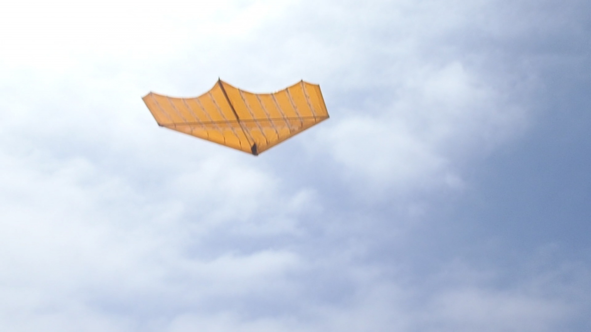

Postby Frank Colver » Fri Aug 17, 2018 9:51 pm
On august 17 with the covering firmly attached to the battens I got the model trimmed for stable gliding flight.
In the photo shown here I launched it from the top of Windsports training slope at Dockweiler. It climbed in the lift immediately to well above my head and then turned along the slope and climbed some more. It flew some distance soaring the slope all by itself (I had no controls) until it finally turned down wind and landed behind the slope.
Directional stability and pitch stability both looked good compensating for mild turbulence.
Encouraged enough by todays flight tests of the 1/5 scale model to start now on the full scale glider. First step will be to design the folding for transport capability of the airframe.
Basic Trainer model soaring the Dockweiler bluff 8/17/2018
