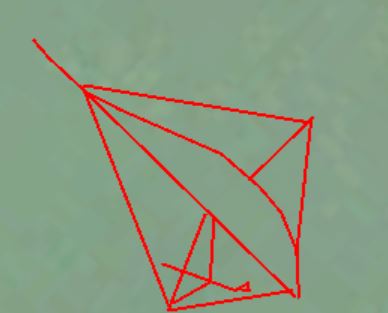

Re: Safe-Splat
Postby Bill Cummings » Tue Jun 07, 2016 10:38 pm
ARP wrote:OK Bill,
If you draw the arc that the pilot follows due to the harness suspension and then do the same for the chest harness it will show where the pilots head will be at any time during a nose in. The further forward the pilot is so the lower he/she would be pulled. When standing upright the pilots head would be closer to the keel.
Tony
Front restraint rope added..JPG (18.01 KiB) Viewed 4499 times
What looks like the far downtube is really the hang strap.
What looks like the basetube is really the ARP Restraint Rope.
Imagine the far downtube is hidden behind the nearest downtube.
Re: Safe-Splat
Postby ARP » Tue Jun 07, 2016 11:31 pm
Hi Bill,
Yes the hang strap and chest restraint strap form a triangle which fixes the pilots head position at a point in space that is away from the keel and the ground. The loads will be directed through the support harness which should spread the load evenly on the body. Provided the air-frame does not collapse the pilot should be in the best position to prevent injury. If the severity of the impact causes the frame to distort or collapse much of the energy will be dissipated in that collapse and so reduce the chance of major injury.
Tony
