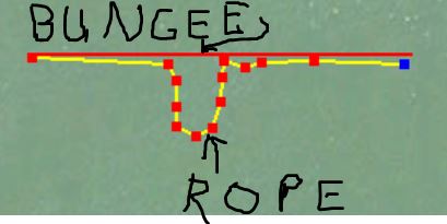

What do you think of a bungee with a rope stop?
Bungee . Rope stop.JPG (18.74 KiB) Viewed 4592 times

Bungee with a rope stop....yes! But the bungee portion needs to have enough slack in it to not interfere with range of motion. Wish I had an industrial sewing machine on site I would whip one out. Will see what makeshift rig I can come up with.
I see both pluses and minuses with every configuration so far.
I think Tonys idea is going work fine, just needs mounted farther to the rear, near to or just behind the center of mass.
