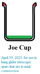

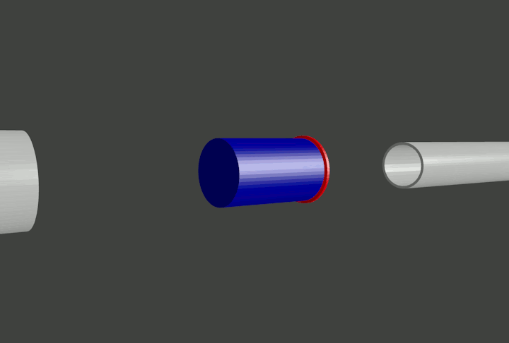

Have circular cross section spar in a hang glider made of three telescopic tubes. Each tube is 5 ft in length. Have no clamps to stop the collapsing of the three tubes into each other except the use of a Joe Sock at the joins. A Joe Sock is a flexible thin webbing construct that looks like a U with a collar at the top; the collar cannot be pulled into the overlap of the tubes that are telescoping; the collar is too fat to be pulled into the gap; the bottom of the U receives the entering end of the smaller telescopic tube. Have hang glider stay line anchored at two of its end, one end at the king post and the other end at the spar at the telescopic join area. But note that the anchoring means at the spar will be achieved by the following design: the stay line terminates to a loop that barely fits around the circular cross-section spar. The loop of the stay line or rigging line is fitted over the spar before inserting the near end of the telescopic segment into the Joe Sock and thus into the larger telescopic spar segment. During flight the stay line will be pulling the loop toward the Joe Sock collar of that join arrangement. The loop being pulled cannot ride or slide past the Joe Sock collar.
ChatGPT
It sounds like you have a unique design for the telescopic tubes in your hang glider spar and are using Joe Socks to prevent them from collapsing. Additionally, you have a stay line anchored at two points, one at the king post and another at the telescopic join area of the spar. The stay line is designed to prevent the telescopic tubes from collapsing further during flight. If I understand correctly, you're concerned about the loop on the stay line riding past the Joe Sock collar, which could potentially lead to a failure of the system.
It's important to ensure that your Joe Socks are properly designed and installed to prevent unintended movement. Here are some considerations:
Collar Size: Ensure that the collar of the Joe Sock is indeed larger in diameter than the gap between the telescopic tubes. If the collar is too small, it might slip through the gap during flight.
Material Strength: Make sure that the Joe Socks are made of strong and durable materials that can withstand the forces exerted by the stay lines during flight.
Installation: Properly install the Joe Socks at the telescopic joins to ensure they are securely positioned and cannot be pulled into the gap. This may involve sewing or securing them in place.
Regular Inspection: Inspect the Joe Socks and the entire rigging system regularly for any signs of wear, damage, or stretching. Replace any worn or damaged components promptly.
Testing: Before using the hang glider in flight, perform ground tests to ensure that the Joe Socks effectively prevent the telescopic tubes from collapsing and that the stay line does not ride past the collar during simulated flight conditions.
Professional Advice: Consider consulting with an experienced hang glider designer or technician who can provide specific guidance on your design and make any necessary adjustments or improvements.
Safety should be your top priority when it comes to hang gliding, so it's essential to ensure that all components of your glider are in good condition and properly designed to withstand the forces encountered during flight.

In the category of "A Picture is worth a thousand words" ... here's about 70,000 words worth:
Personally, I think I'd still take a drill ... and put a pin through it!!
By the way, I'll be especially impressed with ChatGPT when it can make an animation like that ... just from reading this topic.    :lol:
Postby JoeF » Wed Sep 13, 2023 7:17 pm
Thanks, Bob, for the animation effort, time, and skill! :salute: :salute: :salute: :salute:
Some versions of the Joe Sock will not fully fill all the gap between the two tubes.
Some versions are webbing that will doubly invaginate to capture the collar where the collar is a separate item. And the collar is firmly larger for a couple of reasons: never being pulled into the gap and also to play as stopper for stay lines anchored over the spar just wing-tip wise of the collar. A redundancy for holding compression collapse of the telescopy could be drilled hole and shear pin; some may prefer just shear pinning to resist telescopic collapse of the two tubes. I want to keep carbon-fiber tubes without such a hole and pin ... in my early explorations. Also, the flexible webbing Joe Sock of double invagination allows easy experimental stuffing of further shim gap filling. And the webbing Joe Sock is easily exchanged for a longer or shorter Joe Sock to handle varied experiments in depth of overlap of the two tubes.
Full cup collared sleeves to fit experiments gets expensive if the post-support cups are precision made and ordered professionally. Different, flexible Joe Socks with separable collars capture by double invagination can be low cost and customized easily for depth and thickness. Getting a rid of tube wobble is important to reduce concentrated stresses. The webbing Joe Sock with cord-ring collars, thus two parts can be replaced easily after some wear. Differently, expensive precision solid cup pole support collared sleeves do not come with such exchange ease; and fractures in a solid collared cup might be harder to detect.
The Joe Sock will have tension on its body and compression on its collar. The webbing version splits the Joe Sock into two two separable parts: loop of webbing and ring of cord, e.g. The double invaginating webbing with the webbing loop provides the long body; the cord provides the collar. At deep far end of the body of the Joe Sock the smaller telescopic tube would tend to wear the webbing at a higher rate than at other parts of the Joe Sock webbing, so a round separate plug should go into the deep end of the smaller telescopic tube. The plug would be separable for tote; the plug dome would lower the wearing rate greatly. I favor being able to explore telescopy over a large variety of tube and tube diameters and wall thickness and material. The webbing two-part Joe Sock seems to allow quick fittings for variety of tube matching; the shimmable Joe Sock has easy shims placed between the doubled-up webbing on both sides of the Joe Sock; large gaps can be wobble-reduced by such low cost shimming.
I have no access to an imaging AI program. You are my AI. Thanks again, Bob.
The drill-and-pin means certainly will show up in some experiments for limiting the collapse of two telescoping tube segments. Wobble stopping would be addressed with some means.
A mass-produced stable product HG could consider other versions of Joe Sock or gap filling or compression-collapse resisting for telescoping.
Using telescopic tubes that have very small gaps tempts use of single vagination Joe Sock or simply other means resisting telescopic compression collapse.
Note: Shear pinning could be done with one pin or several pins. Also, the pins could project or hold in place a collar that could be used as slide stoppers for stay lines that anchor with surround-spar loop terminals. Several pins could spread the shearing duty, if needed.
Note: semi-wing spar of four telescopic tube segments of 4 ft length would use 3 Joe Socks or other workable means for resisting collapse of the compression that occurs in the spar. The semi-wing after overlap : 16-3(0.5)= 14.5 for a 14.5 ft spar. Tiny pack to 4 ft. length.
Postby Bob Kuczewski » Wed Sep 13, 2023 10:11 pm
JoeF wrote:Thanks, Bob, for the animation effort, time, and skill! :salute: :salute: :salute: :salute:
I was struggling to understand this image from an earlier post:
JoeF wrote:Introducing the "Joe Cup"
I thought a little animation might help people (including me!) understand it better.
Thanks for all of your efforts on the forum ... and elsewhere!!    ;)

Take 24 inches of ribbon that is 1/2 inch wide. Without twist connect the ends with an overlap of one inch; sew and bond that one-inch overlap. This all gives a loop of ribbon. Take another item: a ring of heavy cord. Push a part of the ribbon loop into the inside of cord ring. The pushed part of the ribbon should keep being moved until that ribbon part touches the far side of the ribbon. Nudge the cord ring far way from where the ribbon pushed part meets the far part of the ribbon. Note that the cord part is somewhat captured by the arrangement. A version of the Joe Sock or Joe Cup has been formed. Such might be used during the joining of two telescopic tubes: mount the item onto the smaller of the tubes and then press the affair into the large tube; the cord ring if sized rightly will be a collar that remains visible after the two tubes are join. A small part of the ribbon loop will be seen while the long body of the ribbon loop is hidden inside the gap between the two joining tubes. Of course, the gap and ribbon thickness need to be adequate and planned. If the two tubes have almost no gap, then there might not be room for a Joe Sock or Joe Cup. If the gap is designed to be large, then thicker ribbon can be chosen to make the body of the Joe Sock. Shims may be placed in an extant Joe Sock. Note that the verson of Joe Sock just described will see four (4) layers of the ribbon inside the gap region, two on one side of the tubes and two on the other side. Shims can be placed on one or both sides by placing the shim between the two layers of one side of the tube like a sandwich. Shims might be hard or soft depending on needs or aims. The culprit is potential wobble of tubes because of unfilled gap.
Postby Bob Kuczewski » Fri Sep 15, 2023 12:23 am
That's a pretty good description Joe. The topology reminds me of a common breechcloth (or loincloth) with the front and rear flaps joined to make a loop.
It will be important that the tube edges be very smooth (even polished) to avoid damaging the ribbon.

Flight loads through rigging lines attached to the spars will bring a compression to the inner portions of the spar. The bindings of the 3-2-1, etc. may not give enough friction to counter the compression forces. Binding a strip of rubber could add resist friction to halt spar shortening under compression. Also, a Joe Clip could be used. Or shear pins could be a choice to halt spar shortening. Various builds will select some spar-shortening halt scheme.
Avoid distortion stresses when extending spar.
ChatGPT upon prompt wrote:Thank you for providing the specific mechanical use of the circular arc cusp. It's interesting to know how this geometric configuration can have practical applications in joining and extending structural tubes. Using circular arc cusps to seat and stabilize additional tubes in such a manner can be an effective way to create sturdy connections in various engineering and construction applications. The geometry of these cusps can indeed be valuable for achieving stability and strength in such structures.
Binding wraps?
Explore hook-and-loop strapping. Explore Dyneema webbing sewn to hook-and-loop webbing. Snug three wraps might do the trick. Maybe avoidusing sharp and perhaps hazardous steel hose clamps! Maybe polypropylene webbing sewn to hook-and-loop will suffice. Lash the tubes together for best results with ease of disassembly in mind. Lash tubes so wobble is very minimized.

Some explorations toward getting suitable plugs:
Hidden plugs for the smaller telescopic tube that is inserted into the larger telescopic tube while using some version of a Joe Sock or Joe Cup is explored a bit here: Seek low-mass and inexpensive plugging that will give large radius to handle the inserted end of the smaller telescopic tube. The plug may be bonded to the tube tip or friction fit for easy removal. Since only one end of the tube needs to be with a plug, then permanent bonding may be a choice; the interior of the tube could still hold parts or another telescopic tube. So, the plug need not be separable as hinted in a prior post in our topic. The plus is to exactly match the OD of the smaller tube for its exterior region; there need not be any mass filling any part of the small tube, but a little mass to match the ID of the smaller telescopic tube's ID might be nice for centering and center keeping.
:arrow: End caps
:arrow: Rebar tip safety protectors. Mushroom safety caps. These have more long body than needed. Avoid long body; keep the interior of small tube clear for tote matters, if possible.
:arrow: Slice a segment of a ball and bond that segment to the end of the tube.
:arrow: Bond a bar and then file and polish until desired radius is achieved.
:arrow: Exploring: https://mocap.com/tube-plugs-round.html
:arrow: DIY, wood: file and polish a spherical cap to exactly match OD of spar tube end. Most gentle rounding would be if the equator was involved, that is, full hemispherical cap.
:arrow: DIY plastic or hard rubber: Rough shape and then grind nice radius after bonding to the end of the spar tube.
:arrow: :arrow: etc. :?: :idea: :?:
Only suggestive:
Plug giving end capping for non-cutting radius
