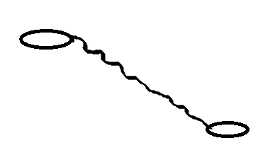

An optional rigging scheme for a soft-line rigging line:
Have a spar. Have a rigging line with a loop terminating each end. Take one end of the line and wrap the spar twice and then run the other end of line through the loop. Snug the line against the spar. Later set the other end of the rigging line on kingpost post or queenpost post. Have the collar of a version of a Joe Sock prevent any sliding change of position of the rigging line's hold on the spar.
The "twice" provides a much better holding of the spar than if the loop was just singly holding the spar. Test distances in order specify exact lengths of the loops and macro rigging line; fulfill one's HG design.
Note: Rigging lines are to be well identified for positioning. A line is to be given a specific serial number. A logbook about the hang glider and its rigging lines would include the dates of initial making and use of each rigging line. The specific line and supplier would be noted. Care and caution notes would be available. The logbook is to be with notes that can help measure the amount of wear and UV exposure that has occurred for each rigging line. Notes about wear and testing are to be kept. Changeouts should occur when prudent.

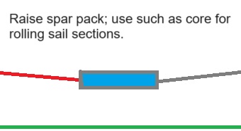

Postby JoeF » Mon Sep 18, 2023 7:32 pm
After flying a Tiny-Packed Hang Glider (TPHG) at a site, consider the following method for packing the sail sections onto a core:
Utilize the environment; if possible, find a tree, post, lifeguard stand, rock, shrub, ... Set up an axle line that passes through the spar pack (refer to the prior post). Anchor one end of the axle line to a remote point, approximately 6 feet high. Then, route the axle line through the spar pack to another remote anchor using an appropriate method. The load of the pack will form a dip in the axle line; maybe get the working height at waist height.
Tension the axle line to support the spar pack and allow it to be rotated by the pilot. Position the sail sections essentially perpendicular to the projection of the axle. Begin rolling the sail sections onto the core by securely anchoring the start of the roll to the core. Remove sand and debris as you roll.
The pilot turns the core to roll more sail material, ensuring air bubbles are smoothed out, and dust and debris are cleared from the sail. Continue rolling while maintaining some tension on the sail using suitable means. One may use hook-and-loop straps to secure the rolled sail sections. Repeat this process for each section, adjusting the number of wraps as needed depending on sail design and section sizes. Target: low tote volume with low crease count.
A helper might up up far end of sail sections, help shake debris, and provide steady tension on the sail while the pilot or someone turns the core while also smoothing the wrapping material.
Other mean to reah target may be found.
