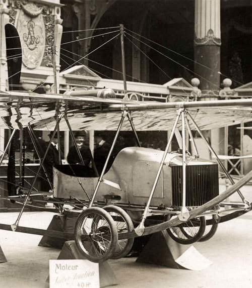

Postby JoeF » Wed Oct 18, 2017 4:29 pm
Part of 1912 exhibition in Berlin:
