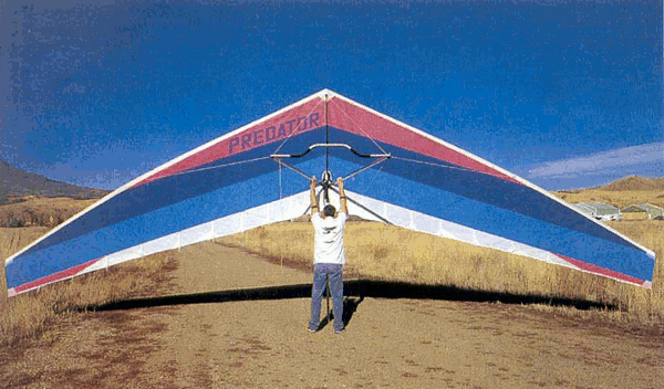

I just happened upon the unfinished Predator model in this topic, and it dawned on me that I could approximate the real measurements by scaling the wingspan of the picture (measured in pixels) to match the known wing span of a Predator (35 feet, 4 inches). So I've filled in this table with the approximate values after scaling. Please beware that these may not be accurate. In particular, the original photo was plan view, so there were no good measurements for the control bar height or the kingpost height. Even so, I think these values will provide a sanity check for Chris if he decides to measure his Predator before coming to Dockweiler. If the real measurements aren't at least reasonably close to these estimates, then there may be a misunderstanding of what should be measured. I hope it helps.
#Name   Estimate   Description
1Length of Leading Edge19'   11.85"Length of the leading edge from nose to tip
2Length of Keel12'   11.17"Length of the keel
3Keel Front y9'   4.19"Distance from the origin to the front tip of the keel
4Keel Rear y3'   6.98"Distance from the origin to the rear tip of the keel
5Wing Tip x17'   8"Distance from the origin to the right wing tip
6Wing Tip z0'   4.37"Vertical distance between the origin and right wing tip (this might be hard to measure, so just estimate it)
7Control Bar Height5'   0"Vertical distance from the base tube to the keel (perpendicular distance from the keel to the base tube)
8Control Bar Width6'   5.95"Width of the base tube from corner to corner
9Control Bar Location5'   5.17"Distance along the keel from the nose to the apex of the control frame
10Control Bar Rake1'   7.67"Horizontal distance along the keel from the apex of the control frame to the base tube (this may be hard to measure, so just estimate it)
11Cross Bar at Leading Edge11'   9.52"Distance along the leading edge from nose to cross bar junction where the cross bar meets the leading edge
12Cross Bar at Keel4'   6.31"Distance along the keel from the nose to the cross bar where it crosses the keel
13Cross Bar z from Keel0'   5.09"Vertical distance between the keel and the cross bar (typically 0 to a few inches)
14Kingpost at Keel5'   5.17"Distance along the keel from the nose to the kingpost (you can also measure from the rear of the keel and subtract from the keel length)
15Kingpost Height3'   0.42"Vertical distance (perpendicular to keel) from the keel to top of the kingpost
16Kingpost Rake0'   2.18"Horizontal distance (parallel to keel) between top and bottom of kingpost
17Trailing Edge6'   9.59"Distance along the keel from the nose to the trailing edge of the sail
18Rear Wire9'   8.38"Distance along the keel from the nose to the rear wire where it attaches to the keel
Also, here's the picture that goes along with those measurements:
