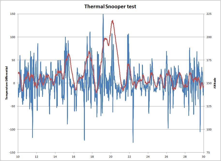

I updated the Arduino audio code a bit to get some additional processing gain. It now does a running average on the temperature differential signal between beeps/boops. That allowed turning up the sensitivity without getting a ton of noise. I haven't shot another video, in lieu of something better...

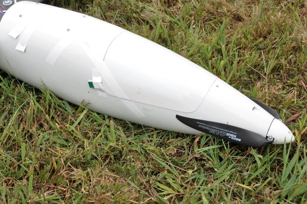

The new snooper took a ride on a model sailplane alongside several other sensors. It was literally hanging outside a hatch unshielded from the sun, but it was quite overcast outside and didn't seem affected by the orientation. Despite the overcast, there was a huge thermal that intermittently sat on the middle of the field and the plane flew through it multiple times. In the two plots, whenever the plane went below an altitude of 150, the motor came on and held it to that altitude. Any climbs above that altitude came from thermal activity and the motor was off. On one plot, the raw temperature differential signal is shown. On the other is a processed snooper signal which needs more explanation.

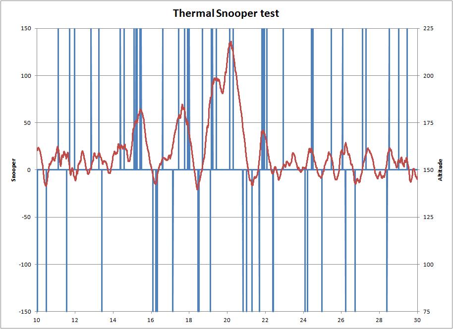

The snooper signal is an implementation of how I think the original Snooper's audio works. The temperature differential signal is integrated. When it crosses a threshold, the integrator is reset and a beep or boop sound is made. If the threshold is crossed in the positive direction, that's a beep and refers to the temperature is warming. If the threshold is crossed in the negative direction, that's a boop and refers to the temperature cooling. In the plot, a beep is shown as a positive line. If there are a lot of positive lines together, that's representative of a lot of beep sounds. Theoretically, that probably means it's getting warmer and probably entering a thermal.
I don't really know what the point of this post is other than to share that the sensor has flown and show the snooper is now in digital processing land. I can plot the snooper versus the vario fairly easily next. It may be interesting to plot the snooper signal versus the GPS position as well to see if it shows flying into the thermal. Who knows??
temperature differential.jpg (76.04 KiB) Viewed 6821 times
processed snooper, similar to the beep/boop audio signal
snooper plot.jpg (80.72 KiB) Viewed 6821 times
There it is hanging out of the hatch.
