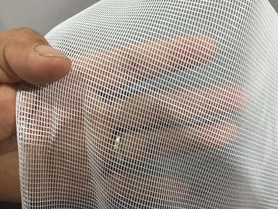

Tease study: white mosquito netting
Tulle fabric exploration for lamination experiments:

User
DIY laminating Mylar film to light fabric netting?
ChatGPT
Laminating Mylar film to light fabric netting can be a fun and creative DIY project, often used for crafting, costumes, or decorations. Mylar film is known for its reflective and shiny properties, making it an excellent choice for adding a metallic or futuristic look to your fabric netting. Here are the steps to laminate Mylar film to light fabric netting:
Materials you will need:
Mylar film
Light fabric netting (such as tulle or mesh)
Scissors or rotary cutter
Clear adhesive spray or double-sided tape
Iron and ironing board (optional)
Pencil or chalk (optional)
Ruler (optional)
Steps:
Prepare your workspace: Clear a clean, flat surface to work on, preferably a table or a large cutting mat.
Measure and cut: Lay out your fabric netting on the workspace. Determine the size and shape of the Mylar film pieces you want to laminate onto the fabric netting. You can create patterns or cut the Mylar into specific shapes as desired. Use scissors or a rotary cutter for precise cutting. It's a good idea to mark the Mylar film with a pencil or chalk before cutting if you need precise shapes.
Adhesive application: There are two main methods to adhere Mylar film to fabric netting: adhesive spray or double-sided tape.
Adhesive Spray: If using adhesive spray, follow the manufacturer's instructions for application. Typically, you'll spray a light, even coat on the back of the Mylar film and then carefully press it onto the fabric netting. Allow it to dry as per the product's recommendations, which may take a few minutes.
Double-sided tape: If using double-sided tape, apply it along the edges or in a grid pattern on the back of the Mylar film. Then, carefully press the Mylar onto the fabric netting, making sure it adheres securely.
Ironing (optional): If you're concerned about the adhesion or want to make sure it's more permanent, you can use a low-temperature iron to gently press over the Mylar-fabric combination. Place a piece of parchment paper or a thin cloth between the iron and Mylar to avoid direct contact. Be cautious with the heat to prevent melting or damaging the Mylar.
Trim excess: Once the Mylar film is securely attached to the fabric netting, trim any excess Mylar film around the edges using scissors or a rotary cutter to achieve your desired shape and size.
Finishing touches: Your laminated Mylar and fabric netting piece is now ready to be incorporated into your project. You can sew it onto garments, use it for crafting, or create stunning decorations as needed.
Keep in mind that Mylar film is somewhat delicate, so handle it with care during the laminating process to avoid tears or wrinkles. Additionally, test your chosen adhesive method on a small, inconspicuous area of the Mylar and fabric netting to ensure it doesn't cause any damage or unwanted reactions.

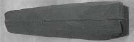

I was unable to find any photographs of the Falcon 4 short pack shipping container that Willswing sells. Even though I think I have seen one at the Sylmar flightpark. Does anyone have a picture of this?
Postby JoeF » Sat Sep 23, 2023 10:08 pm
Falcon 3 short-pack pictured: https://www.yumpu.com/en/document/read/28570928/falcon-3-short-pack-instructions-wills-wing-inc
