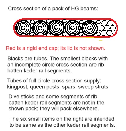

One option being explored:
Bowsprit in two or more packs: Crutch pack of spars and some rib battens. Sail packs made up of rolls of sail segments; roll core: partial rib struts; roll lengths: 36 inches; have about 8 rolls of sail segments: pack and tote in various ways, perhaps one thin pack with rolls side by side, perhaps chest tote or 4 rolls per human leg, or backpack or lap-hold-pack.
Another option being explored uses more tubing, not bowsprit. Still aiming for crutchman and auxiliary polite packs.
Several option scenes include considering no base tube but only base line in TCF (triangle control frame). And considering no macr[url][/url]o sack when crutchman is at the helm; bare the tubes to the public showing as tubes of a crutch.

Challenged by the zipper resistance, I came up with two alternative sail-segment forming and joining schemes. I gave deep prompts to AI ChatGPT 3.5; there are rough notes and errors, but for the record I share the session; again, anyone may run with the concepts I share, and maybe fly with them, or not! :shock: Here goes:
Joe prompts:
Perhaps a new way to have a single-sail (SS) hang glider (HG) sail assembled each flight session from sail segments will be described. Please examine the pros and cons, etc. of the method.

Joe prompts:
My highest value for the direction that segments the sail of the HG is polite toting in small packs on local city buses. In exploring the challenge, some interesting options have surfaced. I will describe what may be a novel means to segment and join segments of a SS HG. Here goes: Let's look at a typical segment and then see how to assemble the single segment of sail with other segments. A typical segment is with final overall width of 36 inches; that 36 inches forms part of the spanwise parts of the macro or finished-assembled HG wing (HG). Chordwise the sail segment is flat on ground overall length of 7 ft.; but only 5 ft of that length will project "wing area" as the other 2 ft wraps around the leading edge spar and returns chordwise for about 1.5 feet to attach by Velcro to the underside of the main sail segment (thus technically the HG will have some significant double-surface dynamics of about 40% of chord or some less. The shadow of the HG sail segment from a zenithal sun would show the 36 inches by 5 ft rectangle of sail segment.
ChatGPT
Thank you for providing more details on your concept for segmenting and assembling a single-sail hang glider (SS HG). It's an innovative approach with the goal of achieving portability and ease of transportation on city buses. Let's delve into the description you provided:
Segment Description:
Width: Each sail segment has a final overall width of 36 inches. This width contributes to the spanwise dimension of the fully assembled hang glider wing.
Length: The sail segment is 7 feet long chordwise, but only 5 feet of that length projects as wing area. The remaining 2 feet wraps around the leading edge spar and returns chordwise for about 1.5 feet to attach to the underside of the main sail segment.
Double-Surface Dynamics: Due to the 2-foot section wrapping around the leading edge spar and attaching to the main sail segment, the hang glider will have some double-surface dynamics, accounting for approximately 40% of the chord or potentially less.
Appearance: When viewed from above (zenithal sun), the sail segment's shadow would resemble a 36-inch by 5-foot rectangle.

This note has a focus: a means of packing five tubes and one bundle of smaller split tubes in a particular arrangement.
Have two caps shaped the same: flattened oval cap with 1" skirt that just snugs six ends of tube ends where the same-diameter tubes are side-by-side and tangent to each other and tangent to the two parallel sides of the skirted oval cap. In practice one of the tubes actually may be a bundle of seven smaller special tubes arranged tightly in a bundle; the cross section of the bundle is a hexagonal close packing of the tubes; six tubes surrounding one tube. The two caps cap the upper and lower end of the proposed backpacking of spars and rib-battens (perhaps not all the rib batten segments). The using four bungee cords kite the two caps toward each other; the two caps keep the two in an orderly pack. Then attach a suspension strap to hang the arrangement from one's shoulders during the time one stands inside a local city bus. After the bus and into trek have the arrangement be the foundation structure of a wheeled travois.
Postby JoeF » Sat Sep 30, 2023 4:58 pm
Further consideration on the backpack:
The above post suggested four bungee cords kiting two end caps to hold tubes. That alone left unbagged could pose a significant hazard to other passengers of the bus if the bungee cords let lose or a cap clipped off. Pow Pow tubes all over the bus. Big liability. Better to overall bag the tubes, but still capped and bungeed. Prevent a possible big spill! :shock: :shock: :shock:
