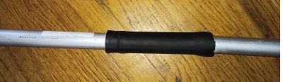

This note addresses a scheme for the sweep-keeping cross tube or spreader tube of some TPHG designs (tiny-packed hang glider designs).
Left Spreader-Tube Subassembly:
Consists of three tubes: A, B, and A.
The A tubes are each 5 ft in length with an inside diameter of 1.5 inches.
The B tube is 2.5 ft in length, and there are two of these B tubes.
The two shorter B tubes telescope into the larger A tube.
Right Spreader-Tube Subassembly is similar to the Left Spreader-Tube Subassembly. When left and right are coupled over the keel, then one has the Spreader-Tube Assembly.
Joining the left and right spreader-tube subassemblies over the keel:
The left and right spreader-tube subassemblies are joined together over the keel of the hang glider.
This joining is achieved using a reinforced rubber tube coupler.
The coupler is secured in position using pip pins.
Inside the reinforced rubber tube coupler, there is a ball.
During flight, positive loads cause the left and right spreader tubes to compress this ball.
The joint will be lashed to the keel to form a firm node to resist buckling in the macro spreader-tube assembly. Then the left subassembly structure provides its center tube for resisting buckling; same for the right subassembly. The two As fit inside a B tube. At tiny packing there are two seen As holding the four Bs. Inside the Bs might be a queen post.
To set the As to the B, a Joe Strap and ring collar could be used; keep wobble to minimum.
The lengths and diameters may change to fit a particular build.
Rough mockup of the rubber over two A tubes just over the keel before lashing the join to the keel. This quick mockup does not show hidden ball and does not show two pip pins. The rough mockup photo also erroneously does not have the Bs close as they should be kissing a ball.
Packing note: One option being explored: Inside the packed B tube will be two A tubes; each A tube about half the length of the B tube. Inside the lined-up A tubes may be 5-ft queen post. Thus upon packing seeing two B tubes would be equivalent to seeing the 2B, 4A, and 2Queens. In pack, then, have 3 longs for the 2 LEs and keel, and the 2 longs just described: total 5 longs (5 ft long). Deep inside those 5 visual longs could also be sections of batten-ribs for the Double Castle sail construction. A sixth long position would be available in the pack for more batten-rib sections and a kingpost; then in the 2"x12"x60" pack of longs there will be small spaces outside the longs for some batten-rib insertions. All such could perhaps be settled into a one carried pack, or a one-crutch pack, or a two-crutch pack; such said, be ready for secondary packs: thin back, robust chest, calf-chin, helmet, worn harness,... When off the bus or other vehicle, all gear can be transformed into a wagon for trekking.
Build notes: A second set of mandrels 6-ft long are ordered and on their way to home. Ten pieces of various diameters. When they arrive, I'll have two sets of the ten sizes, all 6-ft long. These tubes are intended to be mandrels for making carbon-fiber tubes for building various experimental tiny-packed HGs. The two queen posts in a mostly CF wing will remain aluminum for safety sake against splintering CF. Aiing: non-rigid base of triangle control frame in some builds. A large learning curve is occurring regarding DIY CF tube making; tooling up is a challenge; curing oven seems to be a big challenge.
Why two sets of mandrels? Plan is to cure at least two tubes per effort; often two tubes of same inside diameter per effort cycle would be nice. It is expected that my DIY CF tubes will not match the quality of tubes that might be purchased from established tube manufacturers.

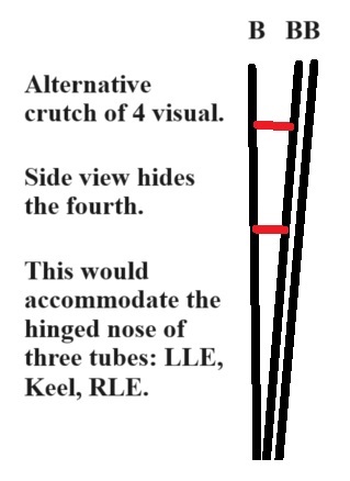

Postby JoeF » Wed Oct 11, 2023 1:29 pm
Looking at this as a possible solution:
Fresh choices for A position as larger telescopic.
Format of crutch is fresh: side view: 2. Front view; 2.
Alternative crutch holding four visuals but in a different
pattern to allow the three-tube nose hinge
integration to retain itself during tote.

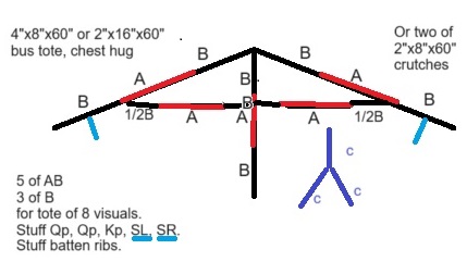

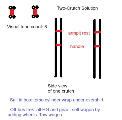

Postby JoeF » Wed Oct 11, 2023 6:49 pm
Above post might be dubbed "One-Crutch 8 Visual".
This new present note might then be called "One-Crutch 5 Visual" where some fresh arrangements are being explored:
Crutch has four tubes visual in its aft portion and one tube in its fore portion. The crutch has exterior hand press control handle. Curved rib-batten fore segments are organized on the side of the crutch. In the cavity between the fore visual tube and the aft visual tubes would be found remaining segments of rib battens, two sprogs, and some other small gear. The five(5) long 60-inch visuals making up the core of the crutch will hold telescopically fitting other tubes. Denote the tube in size of largest to smallest: ABCD. Note: no base to triangle control subassembly, rather tension rope. Note: Sail packed in cylinder style and worn around torso during bus standing. Treks off bus will have all gear and parts and sail transformed to be the structure of a low wagon for towing.
The frame of the hang glider to be so tiny packed then might have these tube sets: Legend: L for left, R for right. Kp: king post. Qp: queen post.
LLE CAB
RLE CAB
Keel CAB
Lspreader B/2,A, B/2
Rspreader B/2,A, B/2
LQp C
RQp C
LSprog D (short)
RSprog D (shoirt)
Kp D
Set of batten ribs segmented as needed to meet the packing restrictions; curved segment gets neatly organized on the side of the crutch. The other segments of the batten ribs fit in the cavity between the fore and aft bigger tubes of the crutch.
The above tiny packs to One-Crutch Solution with 5 visuals:
ABCD
ABCD
ABCD
AB/2B/2C
AB/2B/2C

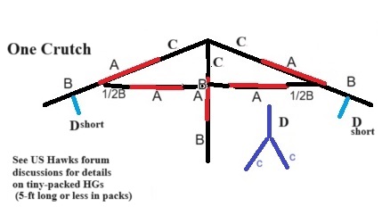

Postby JoeF » Wed Oct 11, 2023 6:52 pm
:salute: :salute: Above post might be dubbed "One-Crutch 8 Visual".
This new present note's HG scheme might then be called "One-Crutch 5 Visual" where some fresh arrangements are being explored:
The frame of the hang glider to be so tiny packed then might have these tube sets: Legend: L for left, R for right. Kp: king post. Qp: queen post. The "-iB/2" stands for a 30-inch segment of B-sized tube, or as needed.
LLE CAB
RLE CAB
Keel CAB
LQp C
RQp C
LSprog D (short)
RSprog D (shoirt)
Kp D
The above tiny packs to One-Crutch Solution with 5 long visuals plus the rib-battens well organized:
A,B,C,D
A,B,C,D
A,B,C,D
A,B/2,B/2,C
A,B/2,B/2,C
The crutch may be controlled as a crutch or hugged to chest as wanted while standing on the bus. Or the crutch may be placed in a small car in various ways. The crutch becomes the spine of a wagon; that is, there is no extra wagon; rather the HG in crutch form is the body of the wagon; add wheels to the front and back of a horizontally placed crutch. Then strap sail and other gear to the arrangement; tow the wagon to launch site or home, etc. Before getting on bus or train, put sail about torso and operate the crutch. Stow wheels in small chest pack or calf-chin pack.
Fresh order of telescopic sizes ... Five Visuals in One Crutch. Torso-held sail. Notice the order on the LEs and keel: C-A-B
