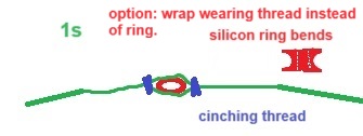

Exploring rigging simplifications hereon:
Top rigging: "1s-1c-1r"
Let "s" be "span." Let "c" be "chord." Let "r" be "reflex."
Let the "1" remind of "one." Assume one kingpost. Consider a collection post at the apex of the kingpost.
Closer look at the "1s-1c-1r" invites a captured centering ring of special design. The centering ring might be embedded in a soft line and cinched with line. Or instead of a silicon ring: consider wrapping main line at kingpost wearing region with a wearing sleeve/thread to protect the main 1s or 1c or 1r line. Bifurcate the 1s or 1c or 1r and protect the bifurcated section and cinch-thread the region. The "1" has one continuous line; for the 1s the line goes from left LE to right LE unbroken; for the 1c the one unbroken line goes from nose to aft keel; for the 1r an unbroken line goes from from aft-left mid-sail to kingpost and then back unbroken to the aft-right mid-sail.
Bottom flight-core rigging: 1f-1q Let "f" be "flight." Let "q" be "queenpost "1" reminds of one line. In this case consider that the 1f goes unbroken from left LE to left queenpost then to right queenpost then to right LE. Notice how 1f allows not having a beam for the base of the TCF (triangle control frame), but a line as base of that triangle.
Consider the 1q as one loop line that serves at once the path nose to queenposts to aft keel which loop has a left portion and a right portion. The left portion of the loop has a fore section and an aft portion; the right portion of the loop as a fore section and and aft portion. The four portions are all part of an unbroken loop. The making of the loop might even involve a specially long-splice braided line. The anchorings at the four points (aft keel, left queenpost, nose, right queenpost) might see in the loop the protective craft rehearsed above.
In a summary: 1s-1c-1r, 1f,1q. Add those 1 deals and see 5 lines.

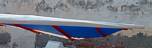

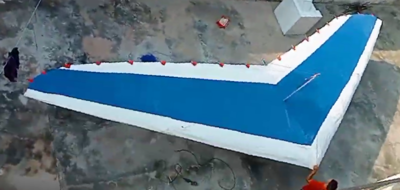

Postby dhmartens » Mon Nov 06, 2023 7:46 pm
a guy in India started building his own hang gliders. Interesting use of a "U" joint.
Postby Bob Kuczewski » Mon Nov 06, 2023 10:03 pm
dhmartens wrote:Interesting use of a "U" joint.
I didn't catch the U joint, but it has a pretty nice looking planform:
Postby JoeF » Tue Nov 07, 2023 8:45 am
Nice find, Doug!
I was not confident that the builder Ravi Gujjar captured a washout-security deal. Maybe he will answer my note at the video comment.
Ravi installed six points of pitch security (three per side stayed to the top of the kingpost).
[In my recent rigging coding, that would be a "3r" where each r results in two points pitch-keeping at the TE region.]
Postby JoeF » Tue Nov 07, 2023 9:20 am
... though this is packed super-tiny,
the guess is that a live human will not be onboard.
