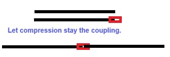

An option in rib-batten formation:
Two CFRP tubes of one meter each. Bond a coupler of aluminum tube to one end of just one of the two CFRP tubes. Upon assembly of HG: let the tension on sail compress the coupled tubes. Upon happy packing: uncouple the two tubes to one-meter approximately stacking.

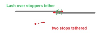

[[Saving a note ... and sharing...;:
Lash overlap plus kited s_____s with "s" as stop; two stops tethered limit overlapping.

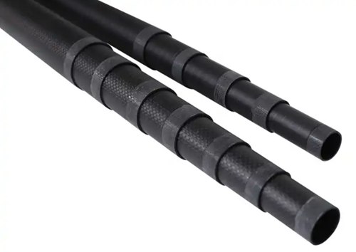

My telescopic 28 inch hangglider made 3 test flights today but it is nose heavy (the nature of telescopic tube is heavier at the base.)
So I either alter the design or add ballast at the back of the keel.
Postby JoeF » Sun Nov 12, 2023 10:20 pm
This note aims to suggest that "telescopic" based HG frames need not necessarily be "heavier at the base" when various tactics are employed.
dhmartens wrote:but it is nose heavy (the nature of telescopic tube is heavier at the base.
What tactics might keep a telescopically-based HG frame from loading the nose region too much?
Consider HGs with spreaders; consider having the central section of left or right leading edge spar be the holder of more mass per span-foot than the section of telescopic tubing supplying the nose region. The telescopy would have the larger diameter and massive tube section at the center section of the left or right leading edge. Let A be larger diameter section, B fitting inside A, and C fitting inside B and D fitting inside C. Note that wall thickness can bring mass; sections need not all be the same wall thickness. So, e.g., have the left LE spar be CAB; the B could be even less wall thickness if such still fulfills safety needs; the A could take the bending beating and the connecting with spreader. Buckling resistance from compression can arrive from a combination of wall thickness and outside diameter. In a CAB left or right LE spar, the A section plays a different role than the B section.
