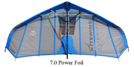

Different kitewing:
https://nordicskater.com/products/kitew ... l-7-0-1919
SKU: S2344
Kitewing Powerfoil 7.0
Vendor Kitewing
Regular price$1,999.00 USD
From $180.43/mo with ...
The Powerfoil 7.0 is optimized for power and weight savings. The Powerfoil is intended for light winds, sticky surfaces and/or heavier sailors who desire more lift. The Powerfoil can be tuned from full to flat. It works on any surface and can fly its own weight in a very light breeze.
The Powerfoil frame utilizes stiff, lightweight carbon-fiber front tubes with the same aluminum boom and Y-tubes that are standard on the other frames. It has a longer Y-tube and a boom extension at the nose joint.
The Powerfoil sail is built at Ezzy Sails from the same 'scrim' used to construct the 5.5 Full and 5.5 Speed sails. The fabric is closely-woven polyester and X-ply laminated on both sides with clear film, yielding a result that is lighter than monofilm. The sail includes Dacron® luff sleeves with Cordura® reinforced openings and chafe points, cam-lock tip tensioners, a two-position reflex tensioner, and a leach strap.
Total weight of the wing is 15.6 lbs. (7.07 kg).

Some background re: prior post on the part re: Kitewing Powerfoil 7.0
WHATS NEW AT KITEWING/ NEW REFLEX STRAP RIGGING PICS
COMPENDIUM 2015 to 2017
The company KiteWing is in Finland.
Their file page: https://kitewing.com/files/?
One file on their 6.0 https://kitewing.com/wp-content/uploads/2019/04/6.0Pro-Brochure-rev1.pdf
Kitewing 6.0 Pro Lightweight, clean set, all carbon frame with two part front tubes for shorter stow. Stable flier.
(my bolding)
Kitewing Powerfoil 7.0 https://kitewing.com/product/7-0-power/
The site Kitewing uses "hang glider":
What is Kitewing ?
Kitewing is a personal hand held wing that allows the user to play in the confluence of solid ground and moving air. Call it wind powered recreating! Most commonly used with skates or skis , but not limited to any other low friction devices.
Why me?
If you are a skier or skater, you can double your fun by using the wind as a tool for recreating. Kitewing is your gateway to a whole new realm of fun.
How does it work?
In a few minutes , the Kitewing sets up into a sail that resembles a hang glider. It floats on moving air, and deftly balances in the hand. Holding the wind in your hands, you control speed and power.
(font size added by me in the quote)
How does Little Hawk by Bob Kuczewski compare with the Powerfoil 6.0 or 7.0 ??? And could a Kitewing 6.0 or 7.0 be modified for a running-wing TCF (triangle control framed) demo hang glider???
