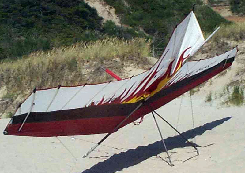

I'm a little late to the game, but I believe there are two fixes for the current lack of pilot safety in a mishap. The first comes from my direct experience. I flew the Fledgling for decades, and more than one pilot came over to say they had never seen me "beak-in" with the glider. There was a simple reason for that. I had my own custom controls rigged (very crudely copied on the Fledge-III) that allowed me to open both rudders fully, and at the same time, flare from about a foot (30cm) behind the triangle bar. (The Fledge-III flare control system was pitiful, IMHO.) Anyway, with twelve square feet (1,1 square meters) of solid drag at the kingpost height, plus the "extra" arm length for the flare, my Fledgling would rotate to a keel-almost-vertical position on the flare. You may core-sample the LZ with the tail of the keel, but the nose would never hit. The flare window was fairly broad in time or airspeed, especially for a rigid wing, because there was no way the glider would balloon up with both rudders fully deployed, if the flare was done a little too soon.
The other approach has been mentioned here already, bowsprits. I believe that the Aeolus was the shape of things to come. I really liked the bird-like planform of that glider. The nose angle was broad, so the bowsprit was not too long or too beefy. It did provide well for the safety of a pilot in a mishap, though. I hear that the Aeolus had a serious tendency to yaw in flight, but I believe we know enough now to remedy that quirk. The vertical fin was maybe too small, or maybe too close to the pilot. The horizontal tailfeathers could also be enlarged, to whatever is needed to insure good pitch responses when needed. I would still like to see the basic design resurrected, with improvements as noted. This would be a bird that I want to fly . . . and it would be safer than the short-keel gliders now available, in a mishap.

Postby JoeF » Thu Nov 09, 2017 8:50 pm
This one?
http://www.delta-club-82.com/bible/354-hang-glider-aolus.htm
