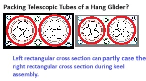

Postby JoeF » Tue Jun 04, 2024 9:53 am
Left rectangular cross section can case the right rectangular crcoss section for keel assembly. The tubes packed in the keel pieces supply wing spar telescopic assemblies and wing ribs, kingpost, and queenposts.
Each shown cross section that is shown empty might further have interior smaller ring cross sections either concentric or kissing rings ala Apollonian gasketing. The ever smaller items might supply camber keepers, stiffeners, battens, camber makers,
Some notes about bundling three tubes in assembled hang glider:
1. Perhaps a thin veil on the tubes' surfaces of silicon could bring helpful friction for stabilizing the bundle. The veil would also help protect the tubes otherwise.
2. Precision pinning the ends of the bundles may be key.
3. Kevlar line or ribbon might be used to bundle the three tubes. Resisting motion of the three tubes relative to each other could be important.

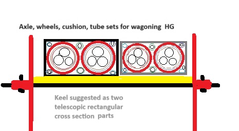

The tote loop that holds the tube pack to the cushioned axle is not shown in the drawing. One elastic loop for each axle, fore and aft.
Two flanged half wheels combine to make one tote wheel. Bolts are suggested in the drawing to combine two half wheels to make one wheel; other solutions might be chosen. Half wheels may mount over crosslined control base scene where lateral mounting might not be convenient.
There is an option to wrap the tube sets with sail segment; else the sail segment could be either worn by the pilot during tote or stored in a second luggage deal.
