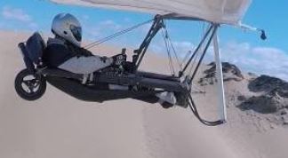

Yes, check the videos of some of my landings at Dockweiler Beach, using "monster" sand wheels.
All but one of the hang gliders I've flown since 1971 have had wheels, mainly as a safety device. I usually landed on my feet but there were times that the wheels were used very effectively.

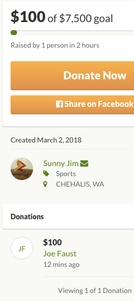

I, Grandpa Faust, put in a first amount for Jim's project. Thanks, Jim, for content and manner!
Joe Faust (aka Grandpa Faust)
Screen Shot 2018-03-02 at 3.10.15 PM.png (46.31 KiB) Viewed 10650 times
Getting the flight started ... with room for more onboard :!:
