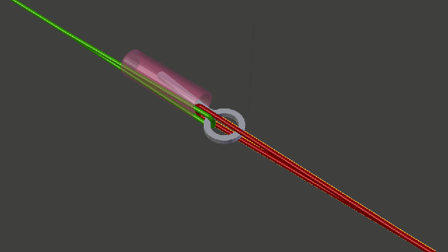

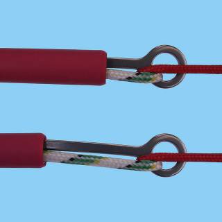

Back on the first page of this topic (posted on February 17th, 2011), I was having a hard time interpreting this picture by Tad:
I was confused because it looked like the red line (on the right) had wrapped around the pin by one complete turn and was coming back out as the white/green striped line going into the barrel. Despite the color change, I was only seeing one line, and I didn't understand how that could work (I had never seen real towing hardware at that time). But after a little study, I realized what was going on. In my second post (also on February 17th, 2011), I suggested that an animated GIF might be a good idea to help folks understand it more easily:
Bob Kuczewski wrote: ... it might be helpful to generate an animated GIF to use for your avatar (or posts) which shows the deployment sequence ...
Well ... over a decade later, I finally got around to making such an animated GIF myself. It's not perfect (and I see a number of flaws), but I think it would help people (like myself) understand the barrel release a little more easily. Here's my animation:
Sorry it took so long (11+ years?). The good news is that I was able to get it done while Tad is still alive and posting on his forum. Tad, if you're reading this, please feel free to use that animation in any of your posts on your forum or elsewhere. :thumbup:
