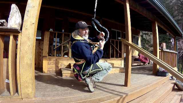

An update on Peters forward cantilevered riser design.....Yes, it works, but in it's current configuration is a solid, 1 1/8 inch tube bent to a certain specification married to continues webbing....a bit awkward in ground handling.
Frank....think about this....imagine risers coming down from the hang point as they usually do....in a straight line between the caribiner and just forward of the pilots buttocks....okay....now make that riser tubular webbing....and a large enough "tube" of webbing to slide some rigid material inside the 'tube" of webbing....now, instead of a solid bar bent to certain specifications, (like my current set up).....imagine the ideal shape of that bar chopped into segments, like the phalanges on our fingers.....and lets connect those "segments" (surrounded by tubular webbing) with joints that freely pivot in one direction (the side facing the pilot) but lets make those joints so they lock up at certain degrees in the opposite direction (facing away from the pilot).
What we would have then are flexible risers that drape over the pilots shoulders and do not inhibit the pilot in any way when the glider is picked up....the risers would simply "curl" under towards the pilot....(via the 'joints' that only allow the risers to "curl" in one direction)....
Then, as the pilot begins the take off run....the 'risers' uncurl but the "joints" inside limit how far they are allowed to "uncurl"....just like the phalanges on our fingers....
Hold your fingers up....perfectly straight....the bend your finger....for most of us our fingers are only allowed to curl in one direction only and can not be "bent" backwards.....so, lets just limit the "unfolding" of our fingers just a little bit so when the finger is straightened as much as possible the finger is still held in a predetermined "curve" away from the pilots shoulders..with "P" representing the pilot and the parenthesis mark representing fully loaded risers that can only unfold to predetirmined degree marks

a few front porch pics of the "phalanges solution'....note:
1. I miscalculated my harness length and yes, I made it a bit "short". Still launches fine but the total height from butt to hang loop should be taller.
2. Even though it launches fine and lands fantastic, a soft, flexible "phalanges" type solution would be more ideal.
I am holding up my finger in this shot to illustrate how such "finger joints" with limitation of forward movements would work....
