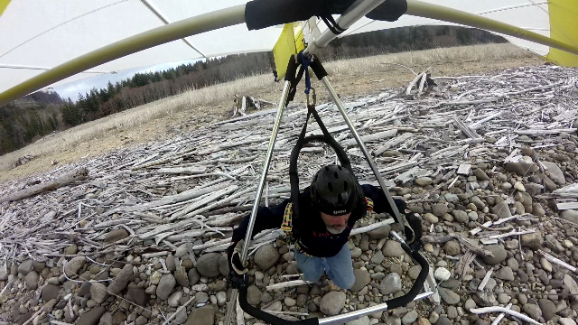

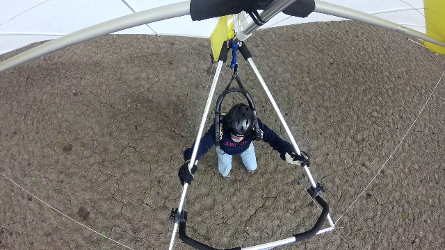

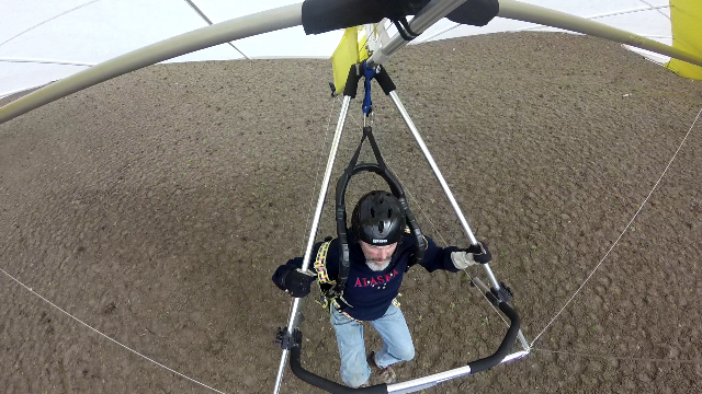

Full flare extension....my shoulders never "bottomed out" on the risers....perfect no step landing
Three flight shots totally out of sequence, I can not figure out how to arrange them in proper order..
1. Full flare to a perfect "no step" landing
2. take off
3. rocked up and ready to flare
So yes, Peter Jamtgaards idea works great....now just invent "joints" to connect "phalanges" that can be sheathed in tubular webbing....and it should feel, take off, and land just like a perfectly adjusted prone harness.....
take off....and yes, I ran over all those sticks and rocks to get airborne...welcome to the NW
rocked upright and ready to flare

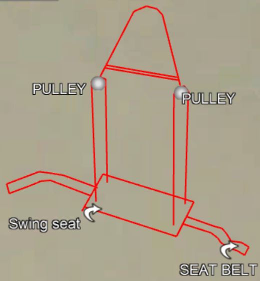

reluctantsparrow wrote:I flew yesterday with the "proof of concept" suprone harness I built last week and referred to in a previous post. Found a small beach to test it on. Ran fine, launched fine, Flared fantastic without having to "rotate" through the risers.....I just ran off a twenty foot high hill (no time for "rotating" arms through the risers) and performed a full flare, stand up landing with plenty of room between the shoulders and the risers to do so. My flare was a full, "flare like an angel" body extension and I did not experience any restrictions on my movement. In fact, I noticed as I "held" the flare and dropped in to a perfect, no step landing that there was still a good couple of inches between my shoulders and the risers....a very successful test..getting closer all the time!
Here is a swing seat I made that allowed me more flare authority. I also put on stops to limit travel.
swing seat with pulleys for flaring..JPG (29.27 KiB) Viewed 12799 times

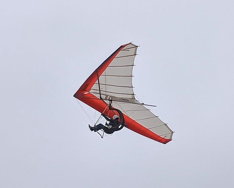

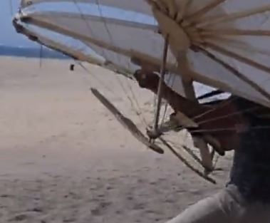

He was at Dockweiler in first quarter of 2018 with his replica of the Otto Lilienthal monoplane normal glider „Normalsegelapparat“. The clip features safe-splat skis that might not have been used by Otto Lilienthal. Markus glided from top of Dockweiler bluff to the bottom of the bluff.

Knee guard:
Re: Safe-Splat
Postby JoeF » Wed Sep 12, 2018 9:10 am

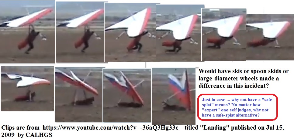

Motivation for several things, but ski or spoon skids or large wheels?
Re: Safe-Splat
Postby Rick Masters » Wed Sep 12, 2018 12:13 pm
If I were training this guy, I would first suggest he try grabbing his downtubes eight or ten inches higher.
This allows a more effective (closer to vertical) flare and a slower landing speed.
You can see in the photos how the glider did not receive a full flare as it continues to fly forward in a partial stall and maybe ground effect.
Also, the pilot isn't even trying to run. What's up with that?         :shock:
In many ways, the correct flare technique can be viewed as the most important part of training (or of flying hang gliders in general).
Without mastering the flare, a pilot is going to get hurt sooner or later.
Wheels, unfortunately, can serve as a substitute for poor landing technique.
Look to the guys who always land well for how to do it.
While I would encourage the use of wheels in training, I also recognize the fact that, while wheels will always make a poor pilot safer, they do not contribute anything to a good pilot's stand-up landing.
The most important landing aid I ever used did not involve wheels or skids.
In fact, it was something I threw off my glider: a piece of tissue paper wrapped around an ounce of flour.
When it hit, it would burst open and drift with the wind, telling me the wind direction and speed at the moment of landing.
From this information, I would know how much flare to give my glider for a good landing.
For the type of high desert flying I did, a guess at the density altitude, based on temperature and elevation, would also factor in.
