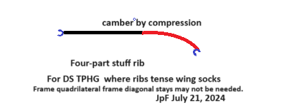

Postby JoeF » Sun Jul 21, 2024 1:32 pm
Development Note on an Optional Path for a TPHG
Consider having socks for covering; and have socks with spanwise inclusion of elastic segment; ribs press and stress socks; the pressing sets up a compression of the special four-part ribs with result of one of the parts forming an airfoil camber.
Ends of the compression ribs will spread the pressing on the spars
The terminal pressure-spreading ends of the compression ribs tote separate from the rib long bodies. The designing of the end brackets is not finished; final prototypes are likely to be different from the drawing.

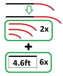

Postby Semper Fidelis » Sun Jul 21, 2024 2:21 pm
First I wanted to have every part strait. Then I tought to make battens to compress to have the aerodynamic shape. But we have to keep it simple and makins so is expensive and because the articulation joints will weight much more thant a tube, I decided to keep only one lenght of strait batten and having the right shape in front of it like the classical battens.
Two parts battens
USHAWKS - NO COMPRESSION.jpg (23.15 KiB) Viewed 1826 times
