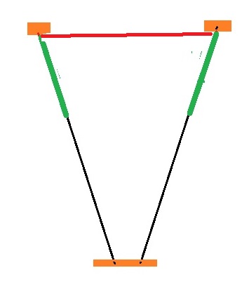

Postby JoeF » Sun Aug 11, 2024 9:18 am
Development Note Regarding a Means
to address Wing Sock Tautness and Chordwise Creep of Sock Sail
The former posted development note did not have the contents of the present note. This present note examines a line-captive V compression rib that has not been mentioned yet in this topic thread. Have two compression ribs set in a V formation with a special pressure-spreading fitting at the apex of the V; that fitting will be loose on the aft or fore spar depending on design choices and results of experiments. Then the two arms of the V are compression ribs with fore parts giving wing camber when compressed inside the wing sock. At the top of the ribs or top of V arms are fittings that also spread pressure on a wing spar. Importantly there is an elastic line that joins the two fittings that are at the ends of the spread-apart tips of the two ribs involved. The elastic line keeps the ends of those two ribs from spreading too far apart when installed; but the elastic connecting line also pulls the ends of the two ribs together forcing the sock to become taut; age creep or flight-forces creep of the chordwise threads of the sock will be mitigated by the elastic line pulling the two ends of the two ribs together. The selection of the elastic tension will be chosen to satisfy sock-tautness needs.
Tiny Packed Hang Glider Movement TPHG
Postby JoeF » Sun Aug 11, 2024 2:23 pm
See prior post just before this post for interpreting the drawing.
Yet, some notes:
See two elemental ribs forming a V shape.
See the red as an elastic with limit-spread sheath. Less than limit spread works to made the V into a sharper acute angle destined to spread fore and aft spars and to tauten sock sail chordwise.
See the ends of the two ribs fitted with fittings that spread the compressed ribs' pressure on the spars.
See the elemental ribs as made of two long parts joined; one part is bendable under compression and gives camber to the sock sail; the aft part stays straight.
To place the subassembly into the interior of the sock, have the elastic connected only to one pressure-spreading fitting. Once all such are inside the sock, then the other end of the elastics can be anchored in order to cause a spreading of the two spars of left wing or right wing. Access in the sock would need to be given; the access doors may be in the lower part of the sock. Zip up the access doors. Set flight and landing lines. Get ready for flying soon.
